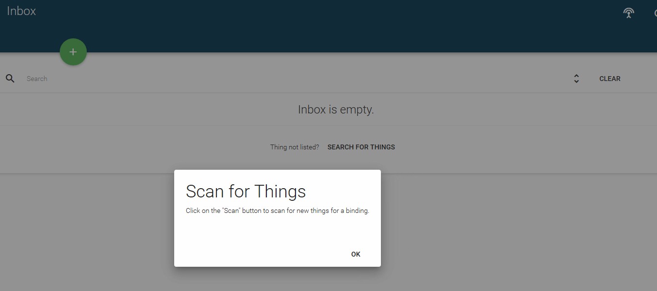

I've a little problem perhaps it's a comprehsension problem on my part.
I've implemented a HandlerFactory extending BaseThingHandlerFactory. My assumption was that when I start scan by pressing the button in the inbox that I get in popup for "Scan for Things" a new entry for my discovery service.
index.php/fa/30883/0/

  • Attachment: paperui.jpg
    (Size: 41.35KB, Downloaded 500 times)

If you really depend on an existing ThingHandler and thus you need to manually register it in the ThingHandlerFactory as you do, please check that you have implemented getSupportedThingTypes() in your DiscoveryService as this is used to determine, which bindings are offered for triggering a scan.
Re: DiscoveryService registered but startScan not executed [message #1773884 is a reply to message #1773882] Fri, 06 October 2017 02:05 Go to previous messageGo to next message
hi Kai,
thank you for your support! I have implemented getSupportedThingTypes() in my DiscoveryService and now it works!!!
