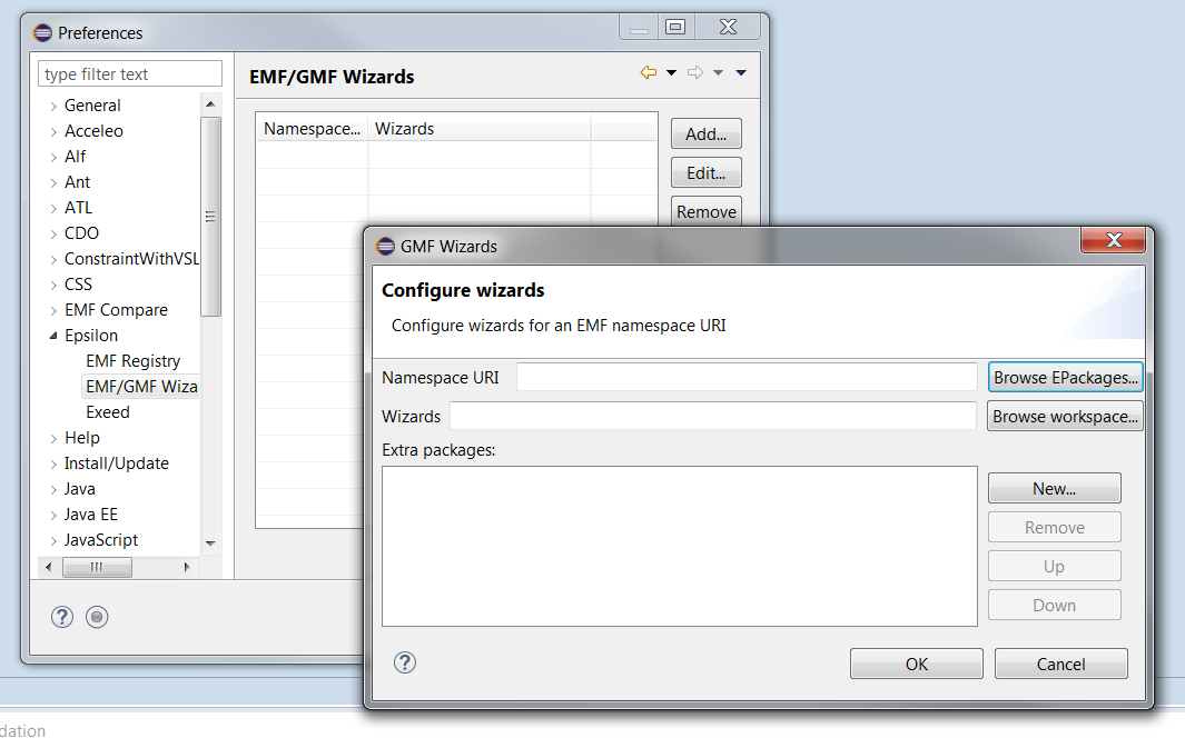

Hi all,
I would like to automate the the steps required to set up EMF/GMF Wizards programmatically.
Is it possible?
I generated a lot of wizards but only few of them may be needed for particular modeling tasks. Therefore, I would like to load them on demand.
A workaround can be the definition of more complex guards. However, it seems that wizards are loaded quite slowly in the Eclipse Context Menu. A dynamic load of that wizards can be a solution.
thanks!
cheers,
Luca

Hi Antonio,
currently I am developing an Epsilon-based framework to support many model management tasks on an annotated UML Model.
I am generating .ewl wizards for each stereotype. Therefore, I obtain as many .ewl files as stereotypes in the applied profiles.
The stereotypes and then .ewl files can be too many.
If you think about MARTE, you might need only a subset of its (sub)profiles to be applied only on certain circumstances (e.g., modeling software entities, then only SRM: modeling platform, then HRM and so on).
In this case, generating a unique .ewl file with all the wizards do not solve the problem because you can save time in setting the wizard (1 file per 1 profile.uml file) but the "Wizards.." menu entry does not work properly (it is very slow or it does not load at all).
In order to solve this issue, I would suggest to implement a kind of dynamic loading of wizards that is influenced by some information (obtained from the model itself in my case).
Can the plugin.xml file be edited and the read again by the modeling environment, in my case Papyrus, while editing the model?
Thanks for your help.
Luca
