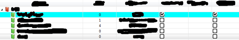

I have a tree/table.
I need to interact with it. I know how to get the value in the tree
System.out.println(ff.bot().tree().getTreeItem("J").getNode("WORD").cell(1));
How can I modify this value?
Example a list, a checkbox, text...

Now, I have a solution.
ff.bot().tree().getTreeItem("J").getNode("WORD").click(1);
ff.bot().text(1).setText("3");
click(1) => click(number column)
