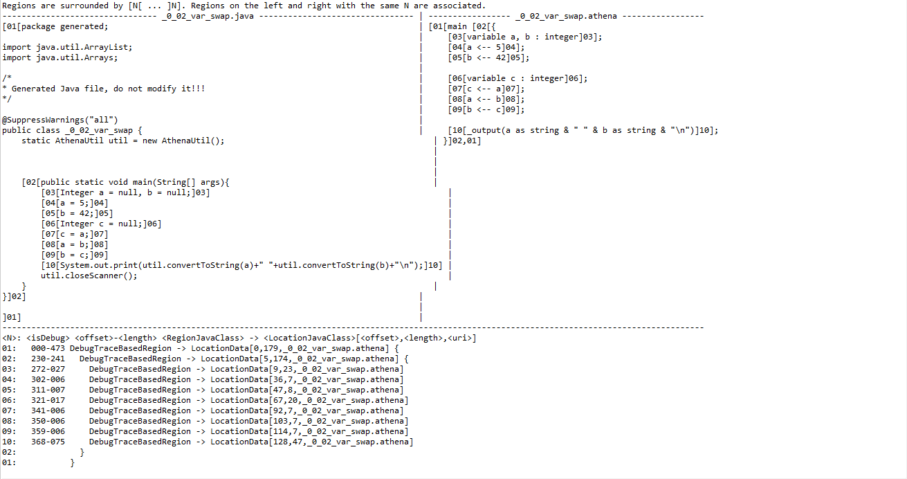

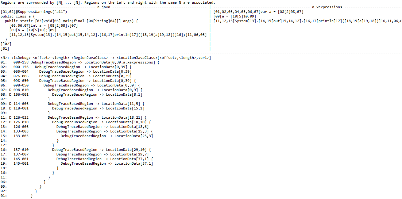

After debugging the org.eclipse.xtext.builder.smap.DebugSourceInstallingCompilationParticipant I have compared the ._trace files generated by an xbase example and by my codegen.
It seems the problem is that my trace files lack the useForDebugging attribute set to true for the required trace regions. The appended files show examples of xbase generated trace and that for my DSL. The regions marked with D have this attribute set to true.
When writing the generator I have followed this example.
How can I set certain lines to be able to be used by debugger (useForDebugging to true in trace region) during code generation?
For example each generated statement from the code below should have this attribute set to true.
Here is an excerpt from my generator.

for me this looks like a bug/missing feature. can you file an issue at https://github.com/eclipse/xtext-core
org.eclipse.xtext.generator.trace.node.GeneratorNodeProcessor.doProcess(TraceNode, Context) sets useForDebugging to false. active annotations dont offer to customize this.
Re: Help with modifying source and variables views during debugging (redirected) [message #1773087 is a reply to message #1773086] Thu, 21 September 2017 06:00 Go to previous messageGo to next message
maybe you can customize a custom traceregionserializer to change the debussing to true always but this might have bad side effects
