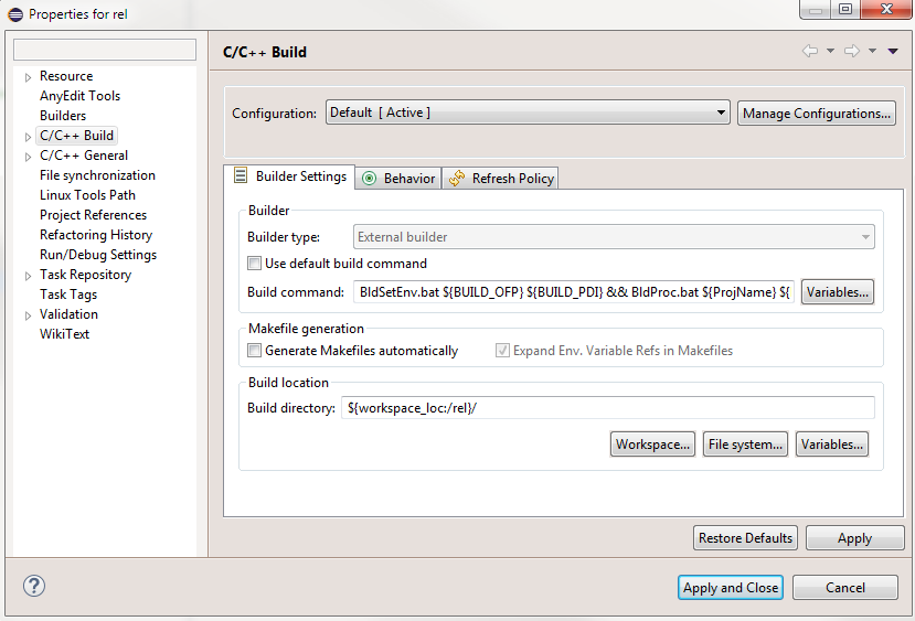

Refer to the attached PNG of the Project Properties Dialog.
I've avoided specifying a DOS path in the 'Build command' text because I not been able to get Eclipse to recognize the relative or absolute path. However, I now find myself finally needing understand how to specify a DOS path in the 'Build command' string.
I've tried ALL the combinations which are valid on a Windows 7 machine. I've googled for any hint of a solution, to no avail.

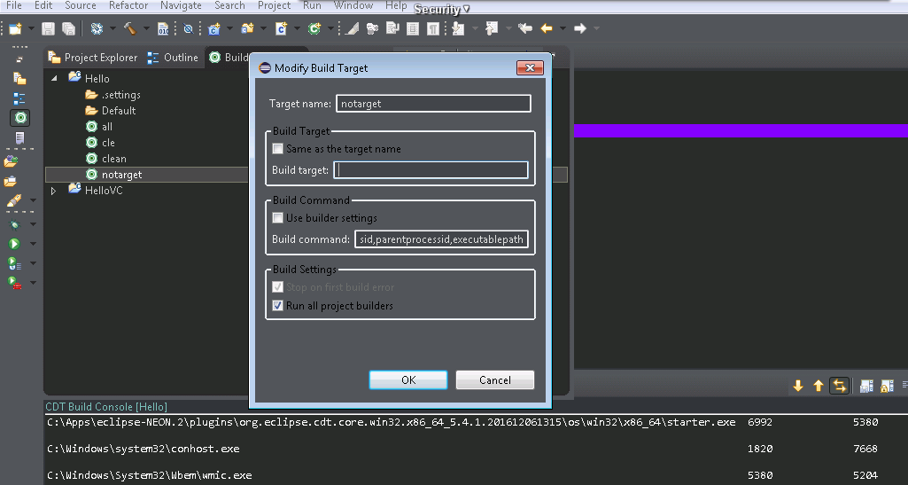

The problem with the Build command is that it is not executed using cmd.exe and a target name is appended.
I created a special target with no name and tried a build using it
The build command is: wmic process get processid,parentprocessid,executablepath
Here's the make target edit and the output followed by what the output looks like from the command line.
Note that the second to last line is showing the parent process is Eclipse and not cmd.exe
index.php/fa/30775/0/
index.php/fa/30776/0/
I tried using the full path to wmic (C:\Windows\System32\wbem\wmic) and that worked.
I also tried using the forward slash in the path and that worked.
Perhaps you can post what is making you think Eclipse isn't recognizing the relative or absolute paths.
