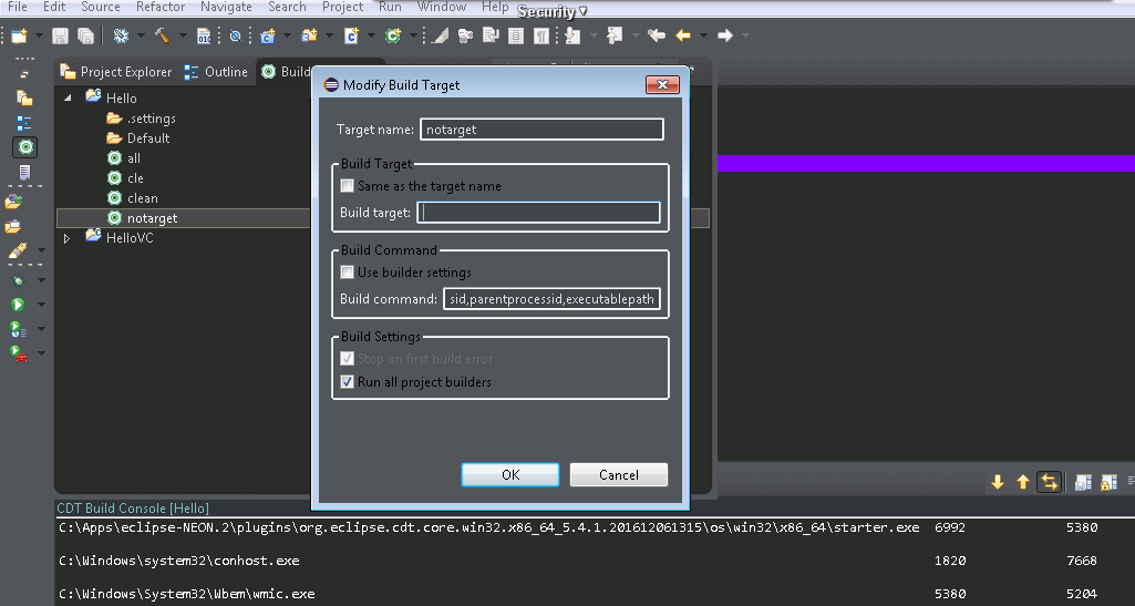

I created a special target with no name and tried a build using it
The build command is: wmic process get processid,parentprocessid,executablepath
Here's the make target edit and the output followed by what the output looks like from the command line.
Note that the second to last line is showing the parent process is Eclipse and not cmd.exe

I tried using the full path to wmic (C:\Windows\System32\wbem\wmic) and that worked.
I also tried using the forward slash in the path and that worked.
Perhaps you can post what is making you think Eclipse isn't recognizing the relative or absolute paths.
