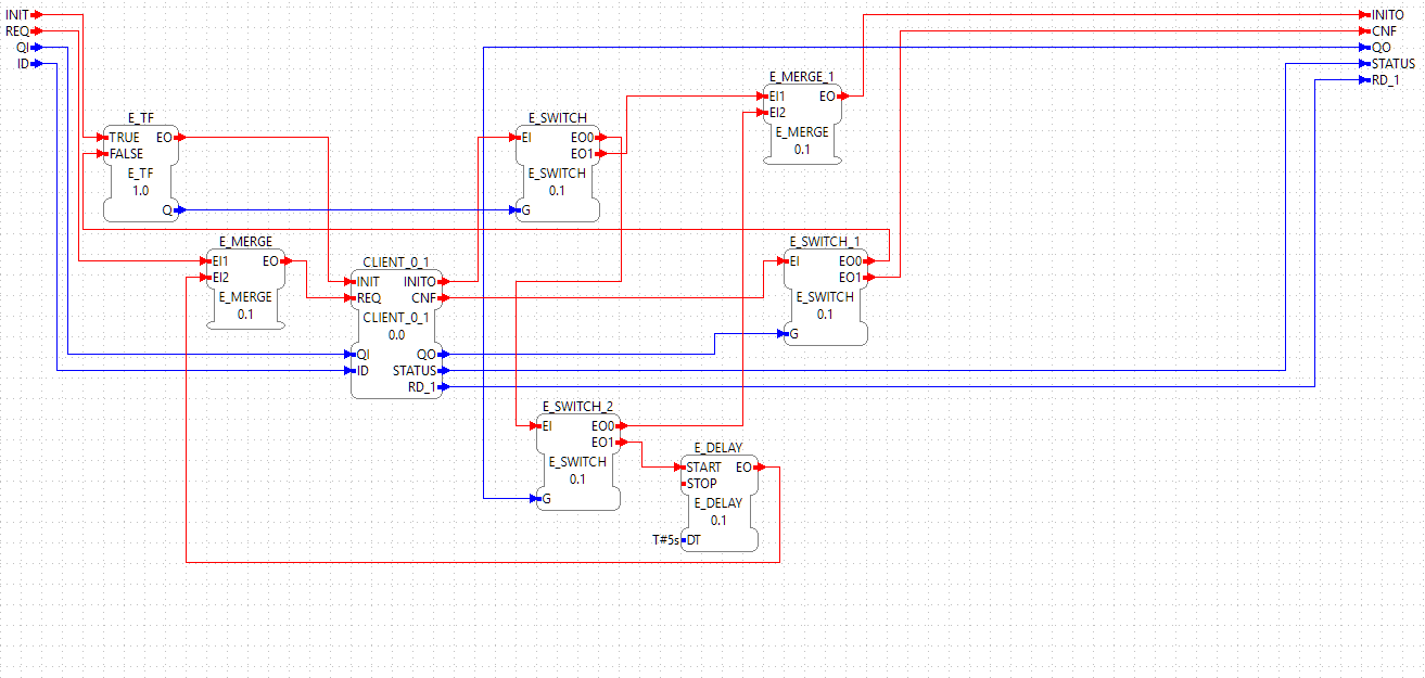

Re: Forte stops running on Raspberry Pi after a certain time [message #1772817 is a reply to message #1772799] Fri, 15 September 2017 11:45 Go to previous messageGo to next message
Thanks for going through this with me :)
Here's the function block network.
index.php/fa/30760/0/
I think it's easiest to understand if I explain how the http layer works.
Using forte's available CIPComLayer class to receive the data is too slow, because usually, the REST server will close the connection before the data is received.
So I created a slightly modified copy of the CIPComLayer (CHttpIPComLayer) that performs all operations - opening the connection, sending data, getting the response and closing the connection from within the sendData() method.
This way it is fast enough to get the response before the peer closes the connection.
An incoming INIT+ event doesn't actually open a connection, it parses the ID and
writes the connection params to a cache, because the socket handler's methods consume the data.
Since closeConnection() is already called at the end of every sendData() call, an INIT- event effectively does nothing.
The com layer is designed in such a way that there are 4 possible outputs:
INITO+
INITO- is only possible if the ID is invalid or QI is false
CNF+ (if an HTTP OK response is received and the body contains valid data)
CNF- (if an unexpected response is received, the timeout is exceeded or the response is invalid)
I only just added the checks for invalid responses, so maybe that'll fix it.
To explain the most important parts of the function block network:
If a CNF- event is output, it loops back to the INIT+ event and then to the E_DELAY FB, which then goes back to the REQ event. This loop goes on until a CNF+ event occurs.
  • Attachment: Capture.PNG
    (Size: 39.08KB, Downloaded 1113 times)

Re: Forte stops running on Raspberry Pi after a certain time [message #1772871 is a reply to message #1772822] Mon, 18 September 2017 03:44 Go to previous messageGo to next message
Thanks for the detailed info! I went through your http layer code. If forte freezes is normally because of an inifinite loop. I think you might have a problem with this section of code:
while ((cg_unIPLayerRecvBufferSize - m_unBufFillSize) <= 0) {
#ifdef WIN32
Sleep(0);
#else
sleep(0);
#endif
Once the code enters this loop, I don't see how it can go out. Maybe I missed something, but you could put a DEVLOG to see when this section of code is entered. If your buffer is fulled, it won't leave this loop.
Here:
openConnection();
if (0 >= CIPComSocketHandler::sendDataOnTCP(m_nSocketID, request, pa_unSize)) {
m_eInterruptResp = e_ProcessDataSendFailed;
you could check first the return value of openConnection() before trying to send, and also break the while if it fails, to avoid waiting the timeout and skip the handledConnectedDataRecv().
Regarding the CSV_WRITER I'm not sure why it freezes. I see only a possible problem that you could have if one of the inputs of the FB is longer than 100 characters, but in any case it shouldn't freeze, just write a shorter string.
And as always, I recommend to put a lot of DEVLOG information, specially when the FB could fail (and its corresponding success branch), since this code is not compiled when selecting a NODEVLOG configuration
