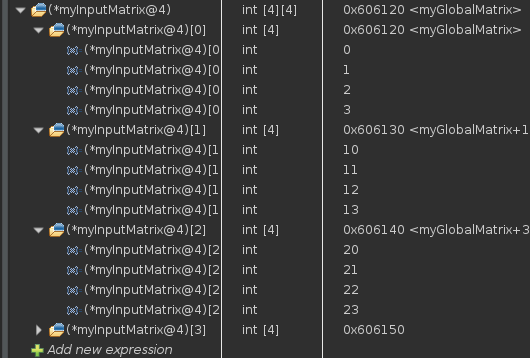

This is likely a bug in the GDB/CDT interface.
Here's something that sort of works: (*myInputMatrix@4)
Looks like:
index.php/fa/30678/0/
I came across this some time ago and don't know where this is documented
Note that it assumes a square matrix (i.e., int [4][4]).
I'm not sure how to make it [3][4]
Every attempt causes an error.

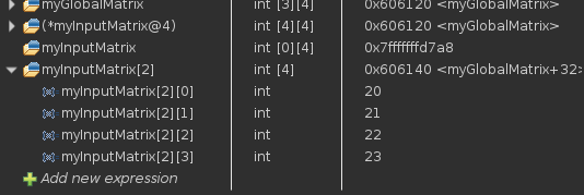

What also works is to cast to type int [][4]
then display with myInputMatrix[x] where x is {0:2}
index.php/fa/30679/0/
