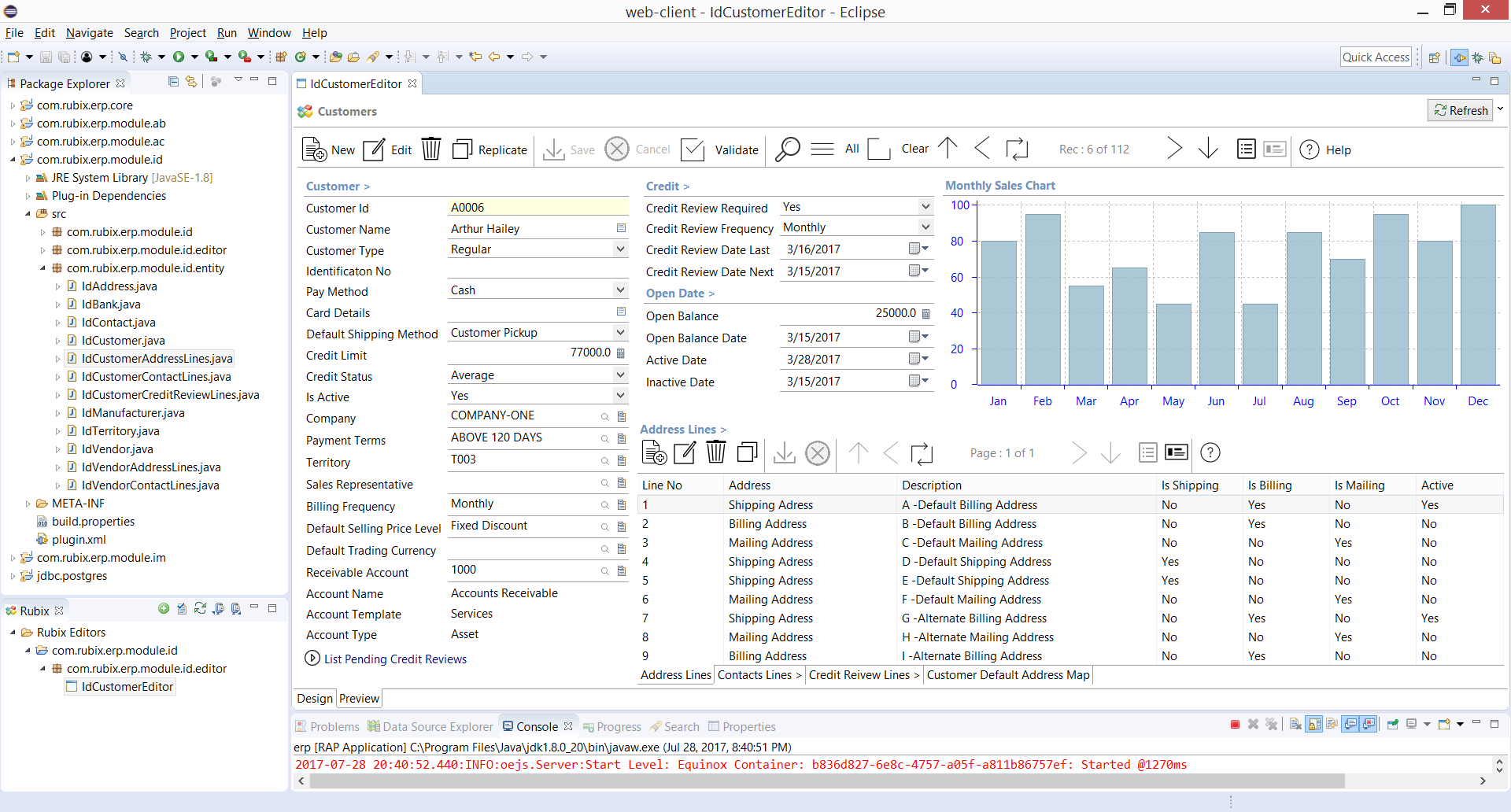

When we have multiple CCombo widgets in an editor, the CCombo-widgets slightly flicker when switching focus between other workbench views/editors. This doesn't occur with other SWT widgets on the ditor. Only happens when focus Package Explorer and re-focus on the editor back again.
any idea ?
