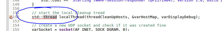

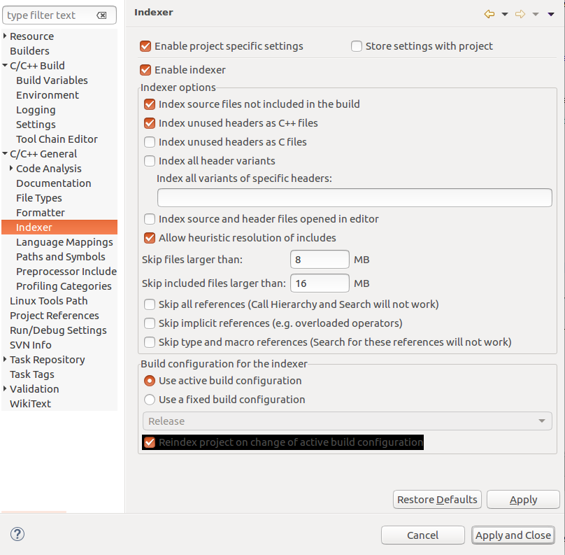

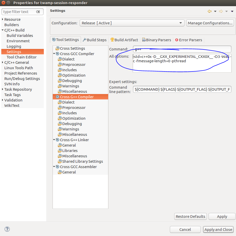

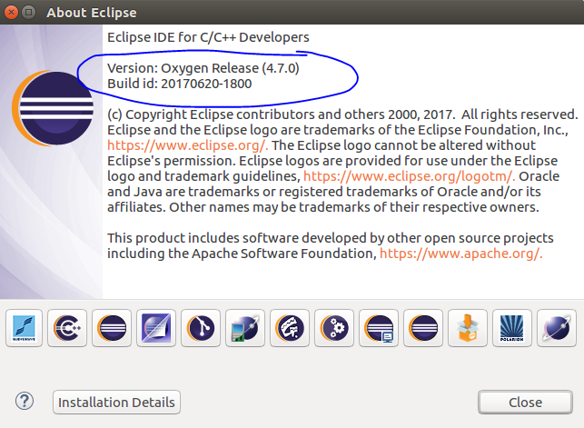

running Eclipse Oxygen 4.7.0 Build id: 20170620-1800. I have already added "-ipthread" flag to cross G++ compiler, selected ISO C++11 language in Cross G++ compiler resulting in the compile sequence "-std=c++0x -D__GXX_EXPERIMENTAL_CXX0X__ -O3 -Wall -c -fmessage-length=0 -pthread"
index.php/fa/30586/0/
index.php/fa/30587/0/
I am still having problems with "std::thread" call, with the hint showing "Type 'std::thread' could not be resolved" as shown below
index.php/fa/30588/0/
no matter what I do. Code compiles and executed fine, but the error is annoying ...

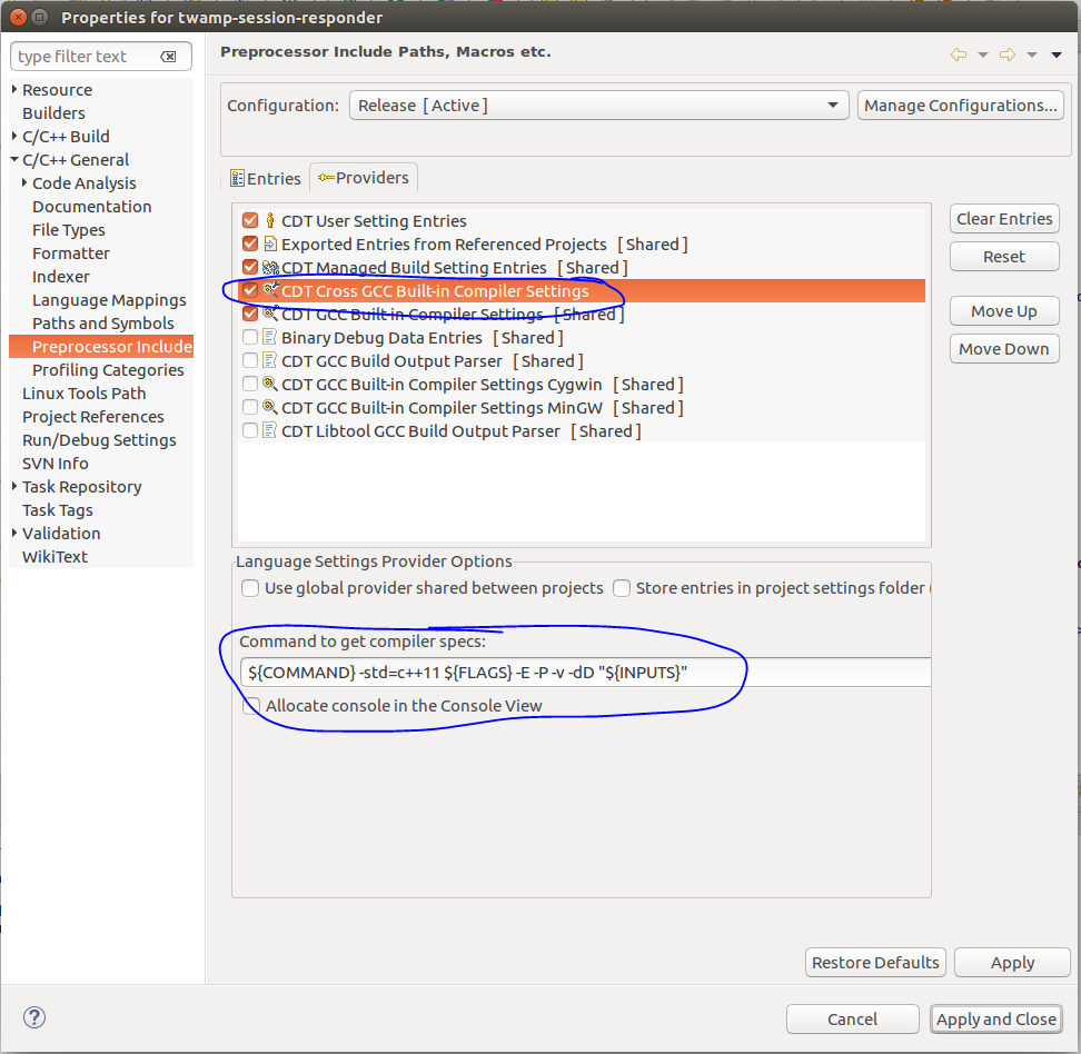

The tool settings for the Cross G++ Compiler affect only the generated makefile used for the build.
The error you are seeing is generated by the Indexer.
To inform the Indexer, you need to select the builtin provider for the cross compiler(or whatever you are using)
and put -std=c++11 in the provider command.
Such as ${COMMAND} -std=c++11 ${FLAGS} -E -P -v -dD "${INPUTS}"
Project --> Properties --> C/C++ General --> Preprocessor Include Paths, Macros etc. on the Providers tab
This is unnecessary with newer versions of GCC as they default to c++11 or higher.

I did have the setting for Cross GCC compiler already, as suggested - here is the screenshot:
index.php/fa/30615/0/
but after several code recompilations, nothing changes and I still have the very same issue.
I noticed though, that when I close Eclipse, restart, problem seems to go away until code is recompiled. Then it is back again :(
Marek

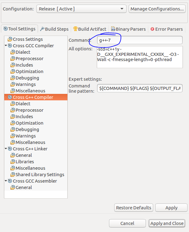

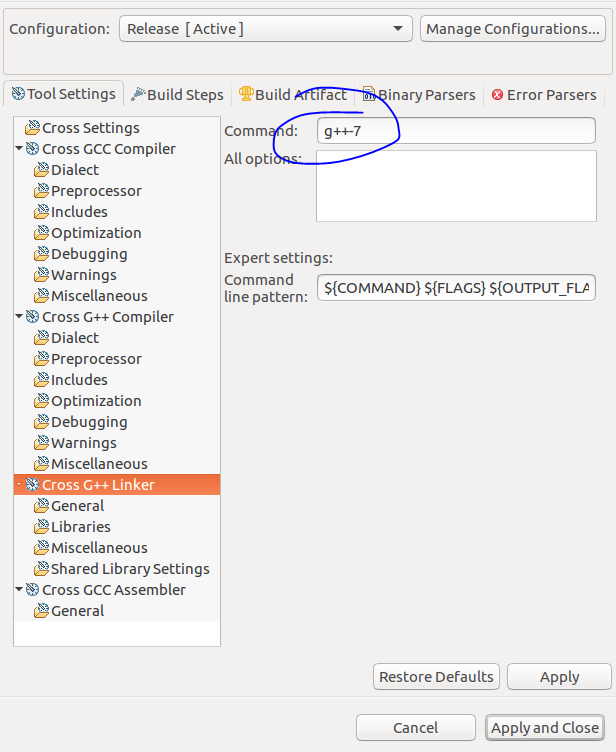

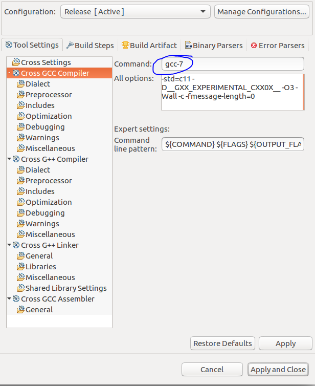

I *believe* I found a way around this problem ...
- install gcc/g++ 6.4.0 or newer
- change default calls in Eclipse for gcc / g++ compiler and linker from gcc to gcc-7 (in my case I installed gcc/g++ 7.1.0) and g++ to g++-7
- add explicit path for include directory to where libraries are installed - in my case, it is "/usr/lib/gcc/x86_64-linux-gnu/7" (this last step does not seem to affect the display, though)
Screens with settings are shown below:
index.php/fa/30633/0/
index.php/fa/30634/0/
index.php/fa/30635/0/
index.php/fa/30636/0/
It has been a trip ... but at least right now building & compilation process explicitly calls out version 7 of gcc/g++, as shown below
20:33:26 **** Incremental Build of configuration Release for project twamp-session-responder ****
make all
Building file: ../src/classStats.cpp
Invoking: Cross G++ Compiler
g++-7 -std=c++1y -D__GXX_EXPERIMENTAL_CXX0X__ -I/usr/lib/gcc/x86_64-linux-gnu/7.1.0 -O3 -Wall -c -fmessage-length=0 -pthread -MMD -MP -MF"src/classStats.d" -MT"src/classStats.o" -o "src/classStats.o" "../src/classStats.cpp"
Finished building: ../src/classStats.cpp
Building file: ../src/main.cpp
g++-7 -std=c++1y -D__GXX_EXPERIMENTAL_CXX0X__ -I/usr/lib/gcc/x86_64-linux-gnu/7.1.0 -O3 -Wall -c -fmessage-length=0 -pthread -MMD -MP -MF"src/main.d" -MT"src/main.o" -o "src/main.o" "../src/main.cpp"
Finished building: ../src/main.cpp
Building target: twamp-session-responder
Invoking: Cross G++ Linker
g++-7  -o "twamp-session-responder"  ./src/classStats.o ./src/main.o   -lpthread
Finished building target: twamp-session-responder
20:33:30 Build Finished (took 4s.210ms)
