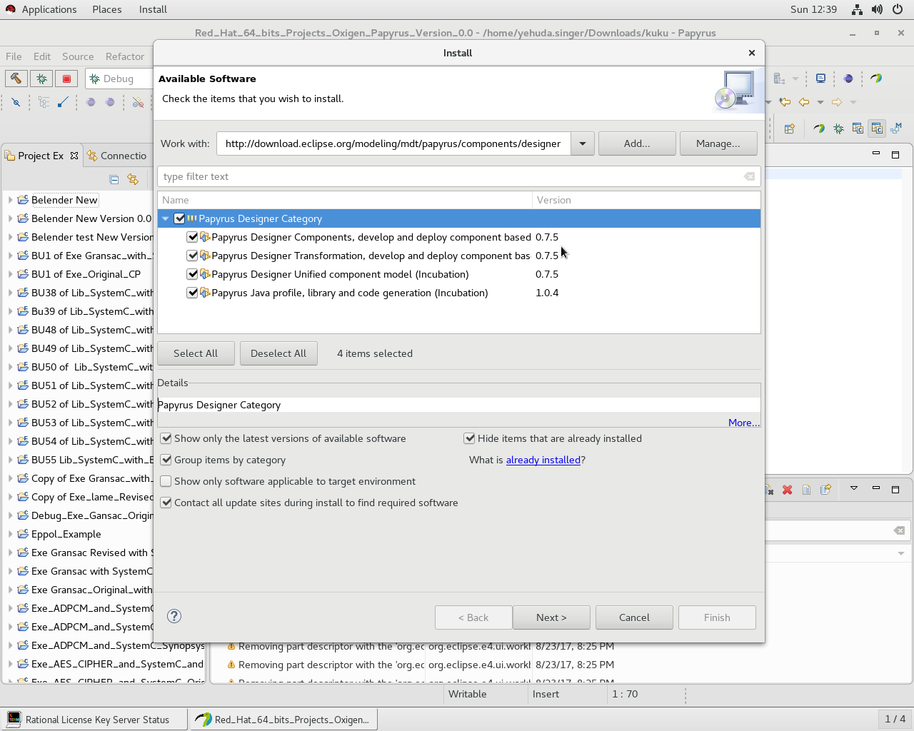

We want to install the designer portion of the papyrus. We used the Install New software in the help of the Eclipse-Oxigen.
We inserted the location:
http://download.eclipse.org/modeling/mdt/papyrus/components/designer

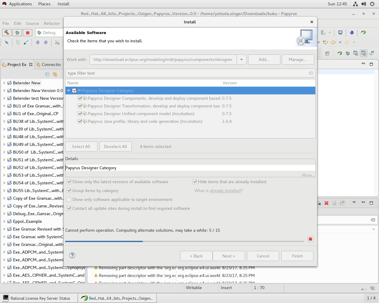

We get exceptions: IDE exceptions. Then we are stuck.
Enclosed please find the screen snapshots.
Please help.

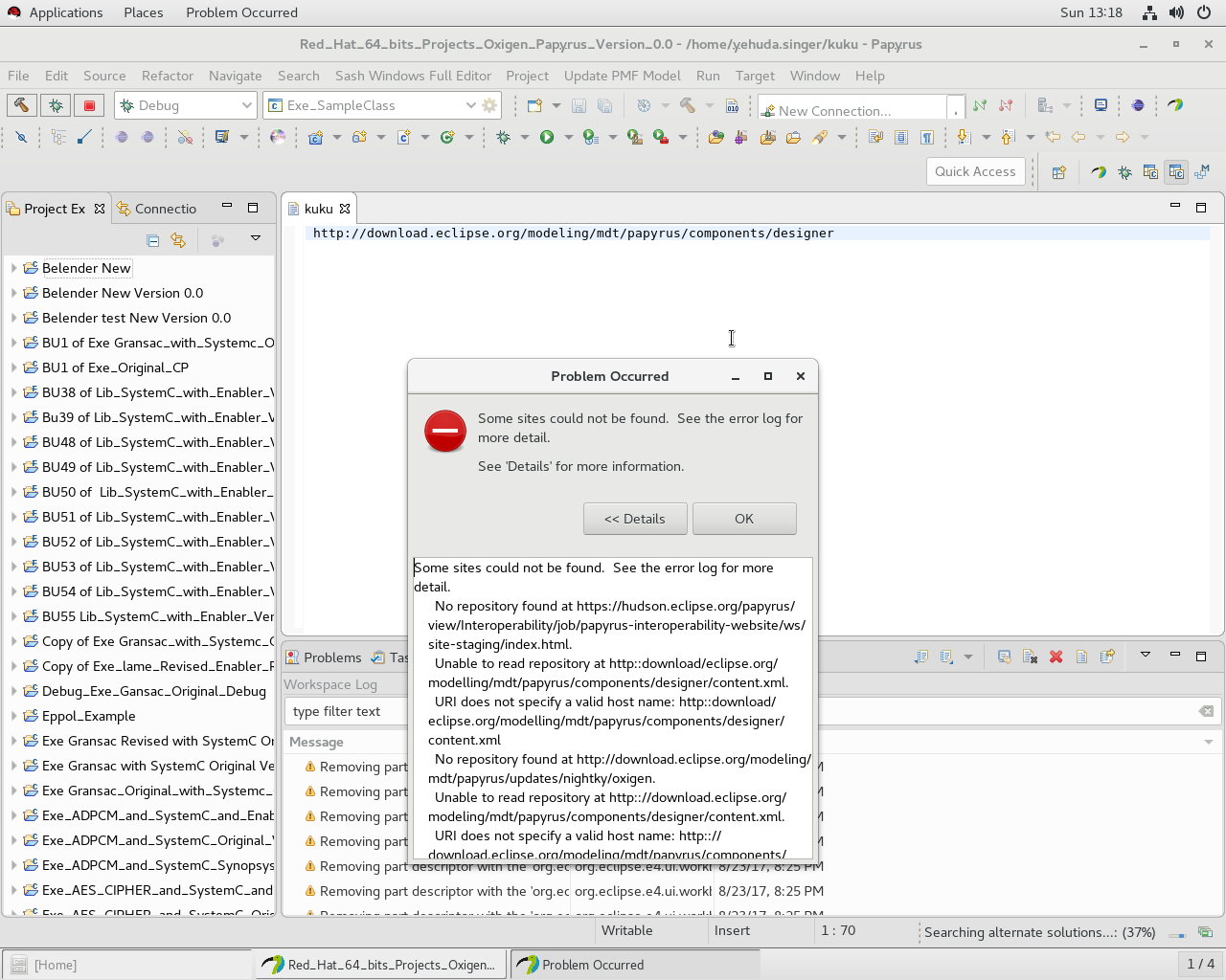

I see from your first screenshot that the update-site for Papyrus-nightly is wrong (you use updates/night*k*y/oxygen, i.e. replace k by l). The SW designer update site seems also wrong (modelling with double "l" instead of a single one). Please double check the spelling of the configured update sites and remove old ones (I don't know why you use the hudson update-site).

Yes, that is the right update site. You can check by opening it in a web-browser.
Also check the update-site for Papyrus itself: http://download.eclipse.org/modeling/mdt/papyrus/updates/nightly/oxygen
You screenshot has an entry with http:://...oxigen. Replace :: by a single ":" and write oxygen with a "y"
