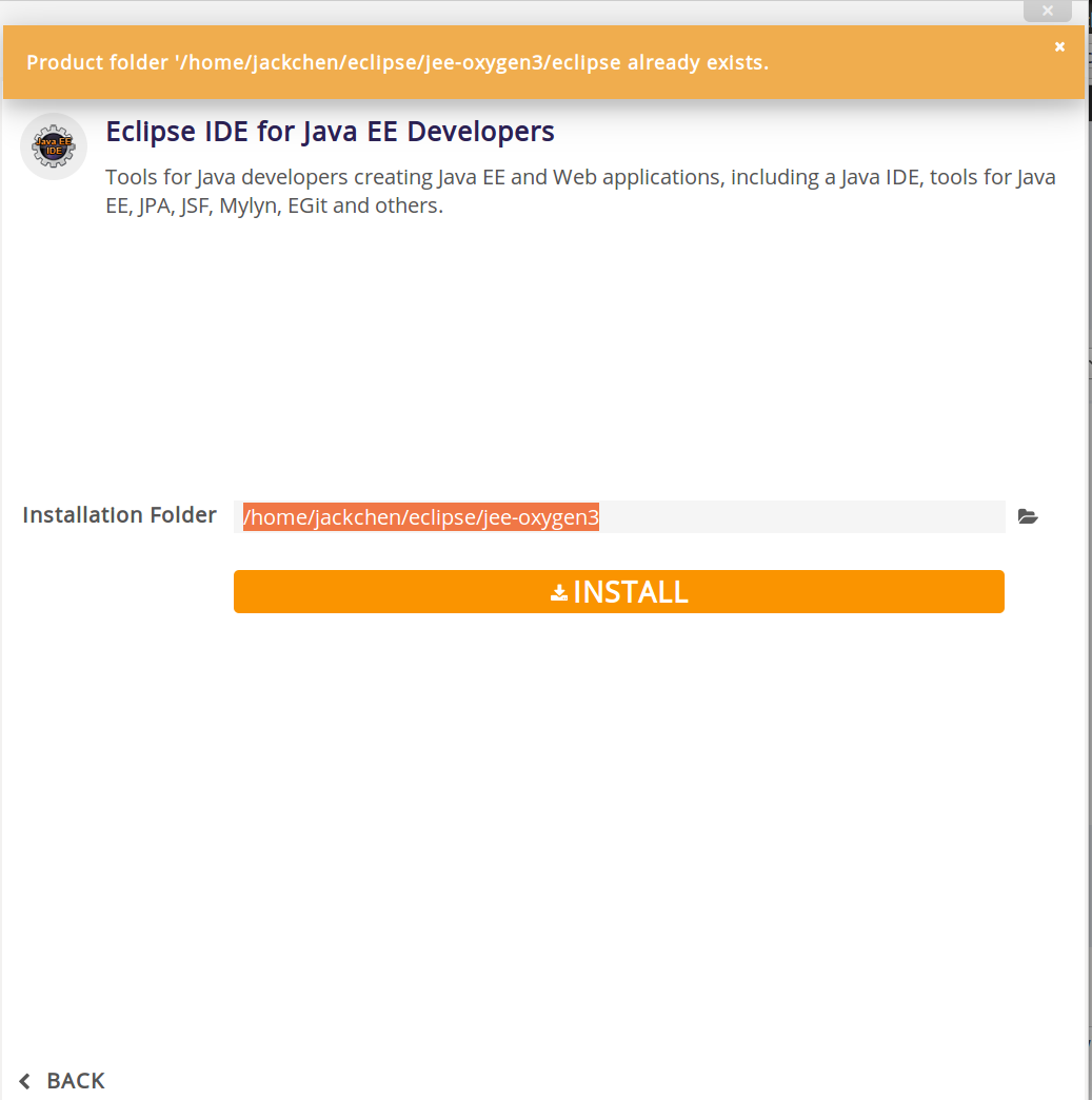

index.php/fa/30560/0/I download latest version of Eclipse from https://www.eclipse.org/downloads/download.php?file=/oomph/epp/oxygen/R/eclipse-inst-linux64.tar.gz&mirror_id=1207 and install it.
I am in the my home directory with the user's permission to install it.
EX: jack@XXXX:~/download/eclipse-installer$ ./eclipse-inst
but throws error exception
Please help me , Why is there an error?
thank you~

Re: Can'nt Install Latest Eclipse in Ubuntu 16.04 [message #1771927 is a reply to message #1771919] Fri, 01 September 2017 04:55 Go to previous messageGo to next message
It looks like there was a network failure. The download server have been acting up lately. You could try again in a while. Then you try to install a second time in the same location and it's warning you that you'll overwrite what's there, which is okay as long as you're okay overwriting that installation (which is fine if the previous time failed).
