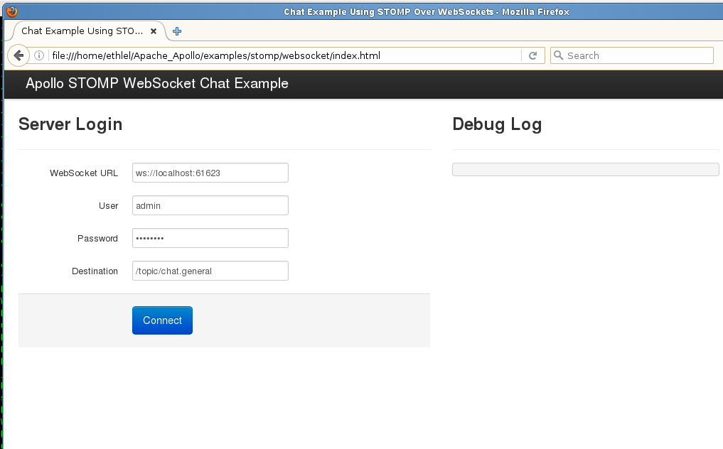

and login with the following parameters:
Websocket URL : ws://localhost:61623
User, Password as configured (default login id and password is "admin" and "password"- don't forget to change this in aproduction environment).
Destination: /topic/chat.general
index.php/fa/30546/0/

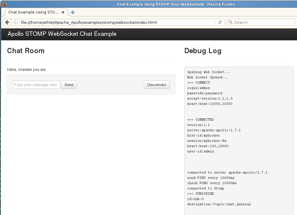

Now the code executed in the browser will connect to the message broker as a chat client; in the Debug Log window in the right the message exchange can be monitored.
index.php/fa/30547/0/
All connected and subscribed clients will be dispatched the messages sent to this topic.The TTCN-3 code will connect and subscribe in a similar manner.

The message sent by the TTCN-3 code appears in the browser chat.
