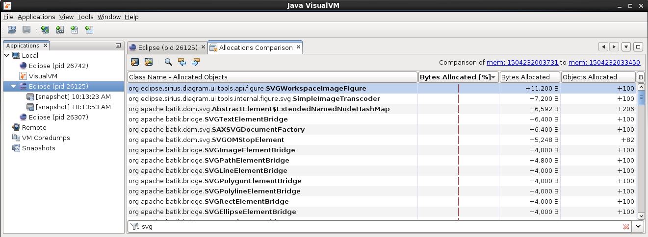

I tested "making a blank modification in the aird file+save with an external editor", and I use "jvisualvm" to take snapshot of the eclipse before and after blank modification of aird file, before take snapshot i did garbage collection. And i compare the two snapshots, it shows the allocated objects of SVG*** will be increased, as show blow.
index.php/fa/30559/0/
I report this on bugzilla https://bugs.eclipse.org/bugs/show_bug.cgi?id=521718.
