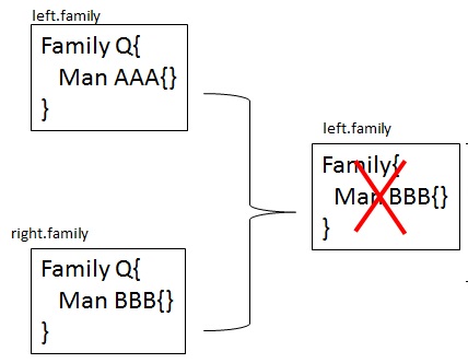

I am the freshman of EMF merge. I want have a simple way to merge two file into one: only merge the right part difference into left.
As the figure:
index.php/fa/30522/0/

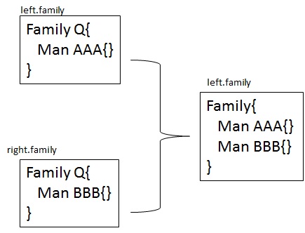

But when I follow the sample: TwoWayatchMerge, the result will change the Man AAA with Man BBB in left.family.
index.php/fa/30523/0/
        final IComparisonScope scope = new DefaultComparisonScope(leftResourceSet, rightResourceSet, null);
        Comparison comparison = EMFCompare.builder().build().compare(scope);
        final EList<Diff> differences = comparison.getDifferences();
        IMerger.Registry mergerRegistry = IMerger.RegistryImpl.createStandaloneInstance();
        final IBatchMerger merger = new BatchMerger(mergerRegistry);
        merger.copyAllRightToLeft(differences, new BasicMonitor());
Please give me some help. Thanks.

In this example, EMF Compare is matching left's AAA with right's BBB, in other words we only see one "Man", not two. Thus, the difference we see in there is that "the man's name changed from AAA to BBB", not "man BBB has been added". Merging this difference will then change the man's name instead of adding another one.
This is due to there being too little differences to say that the two men are "different". You will have to either make more differences between the two models so that emf compare can properly differenciate the two "man" instances, start to use IDs to differentiate your items, or customize the matching so that EMF Compare uses the "name" of your objects as an identifier instead of just another attribute. More on this last point in the documentation.
