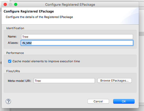

I want to specify metamodels and their aliases not aliases of models. In my EOL program, I navigated the Input and output "metamodels".
[Updated on: Mon, 28 August 2017 03:45] by Moderator
Re: set the aliases of metamodel in standalone [message #1771572 is a reply to message #1771566] Mon, 28 August 2017 04:36 Go to previous messageGo to next message
You can then use the EmfMetaModel class instead, located in the org.eclipse.epsilon.emc.emf package as well. As with EmfModel, EmfMetaModel also inherits the getAlias() method from the IModel interface so you can use it as suggested in my previous message.
