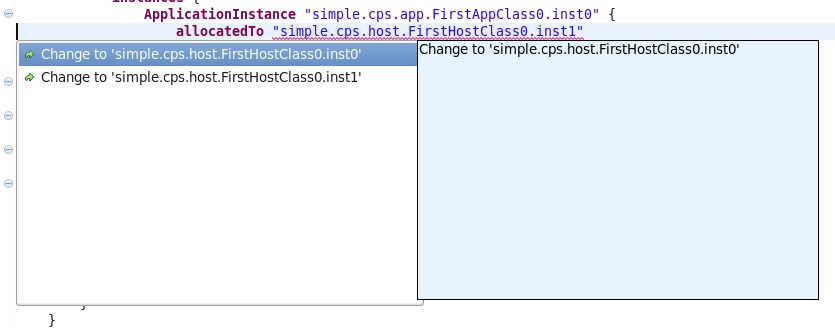

When I create a model using xtext(the DSL grammar is generated by default.)
It always alert the error about "Couldn't resolve reference to *** problem"
The Reference name as "sample.cps.host.FirstHostClass0".
index.php/fa/30485/0/
I only change the NameProvider in Xtext, because I want us the name as the ID. But if do not have this kind of change, the model part also alert this problem.
Dose anyone can help me to fix it?

Re: Couldn't resolve reference to *** problem [message #1771351 is a reply to message #1771348] Thu, 24 August 2017 06:12 Go to previous messageGo to next message
you may not call QualifiedName.create(ide.identifier)
if identifier contains a .
use an Injected IQualifiedNameConverter instead
Re: Couldn't resolve reference to *** problem [message #1771365 is a reply to message #1771351] Thu, 24 August 2017 07:40 Go to previous messageGo to next message
Great~! It works! Thanks for you quick replay. Christian.
And I think I need deeply study Xtext help document.
Thanks again.

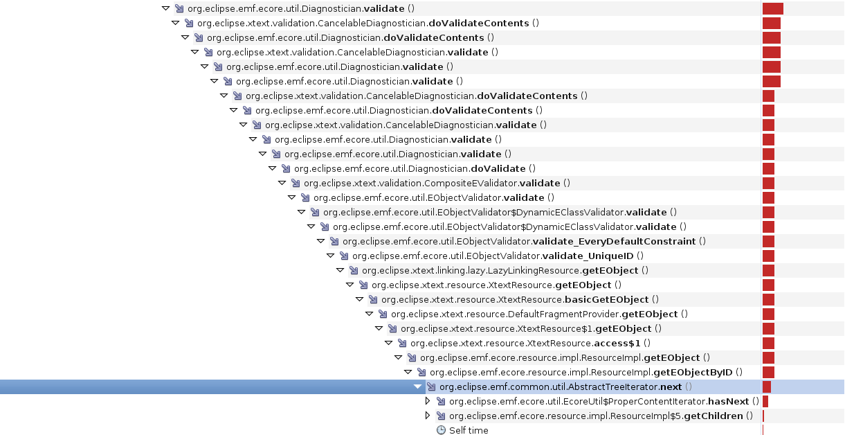

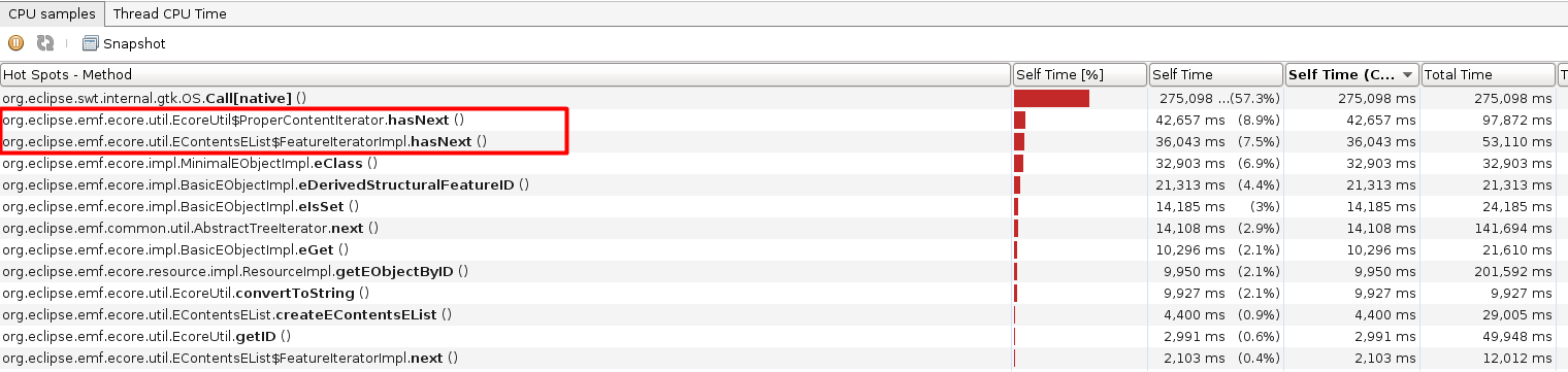

Re: Couldn't resolve reference to *** problem [message #1771420 is a reply to message #1771376] Thu, 24 August 2017 22:17 Go to previous messageGo to next message
Yes, I will.
After I use Java VisualVM to monitor the Eclipse platform, when open a big size xtext file using xtext editor.
I find that the org.eclipse.emf.ecore.util.EcoreUtil$ProperContentIterator.hasNext() take a long time. And it is called by xtext.validate .
index.php/fa/30504/0/
index.php/fa/30505/0/
So how we can handle this problem?
Do we have a way, only trigger the Xtext validation at the saving time.
Re: Couldn't resolve reference to *** problem [message #1771423 is a reply to message #1771420] Fri, 25 August 2017 00:28 Go to previous messageGo to next message
do your objects have ids? this is unusual
Re: Couldn't resolve reference to *** problem [message #1771426 is a reply to message #1771423] Fri, 25 August 2017 01:30 Go to previous messageGo to next message

Re: Couldn't resolve reference to *** problem [message #1771433 is a reply to message #1771432] Fri, 25 August 2017 01:55 Go to previous messageGo to next message
argggg we are talking not about the same thing.
ususally validate_UniqueID
does nothing since EcoreUtil.getID(eObject); returns null.
why does it find an id in your case.
please debug.
that validate method is a default emf method and its impl might have a bad o(n2) implementation
