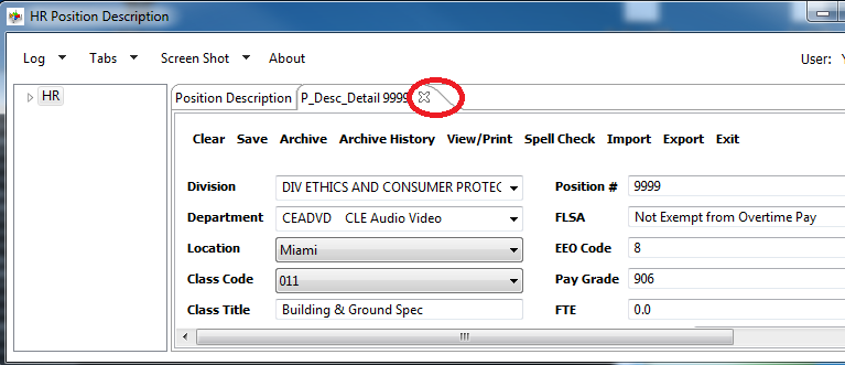

I have one stand alone Java SWT application and CTabFolder and CTabItem items were used. When user try to close one CTabItem by click on "X" icon beside CTabItem title, I want to pop up one window and give user option to cancel this action or continue to close it. I implement this function by adding below code, but we can't cancel this action and only can do some thing before it close. How to cancel this "close action", user select cancel in pop up window. Thanks. Gary
