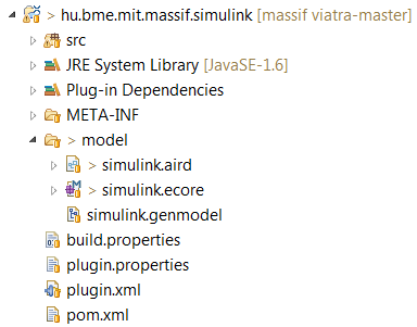

I have my EMF metamodel:
Also I created edit and editor projects:

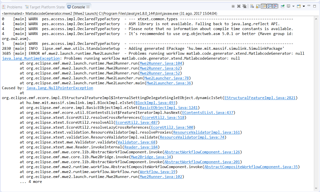

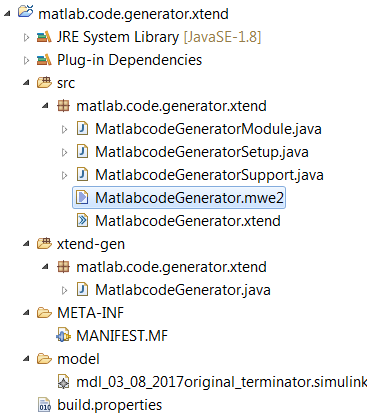

This is my workspace view:
Until all these steps everything work fine. Now when I run the workflow I get these errors:
Can you please help me?
Thank you very much!

Re: Xtend template using a Metamodel (ecore) [message #1771862 is a reply to message #1771861] Thu, 31 August 2017 09:25 Go to previous messageGo to next message
lloks like something is broken with your xmi
Re: Xtend template using a Metamodel (ecore) [message #1771863 is a reply to message #1771862] Thu, 31 August 2017 09:28 Go to previous messageGo to next message
maybe you can turn off the validator in the wf
component = org.eclipse.xtext.mwe.Reader {
validate = org.eclipse.xtext.mwe.Validator.Disabled {}
any this dynamic stuff makes me wonder. dont you have a genmodel/java classes generated?
