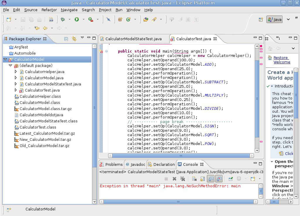

Dr. Merks, I have updated the CalculatorModel.java as instructed in the book. I recompiled individually the four files from the terminal with OpenJDK into class files. The two files, CalculatorTest.class and CalculatorModelStateTest.class run when invoked from the terminal!
But Eclipse Console shows this error message:
Exception in thread "main" java.lang.NoSuchMethodError: main literally in Red!
Now I got a clue when I ran the other two Terminal-OpenJDK compiled files, CalculatorModel.class and CalculatorHelper.class. In either of the cases, the error messages are displayed in the console:
workspace/CalculatorModel$ java CalculatorModel
workspace/CalculatorModel$ java CalculatorHelper
So what I figured is that Eclipse runs simultaneously all the four files and then shows the first error message and then the Eclipse console is exited. A snapshot is here:index.php/fa/30461/0/
So how to individually compile the four files in eclipse (like I do in the Terminal with OpenJDK) and then run only the executable files from the source .java files that have main() functions ?
I attached both the Source Java files Latest_CalculatorModel.tar.gz as well as the Class files CalculatorModel.class.tar.gz compiled from terminal using OpenJDK.
I also give a snapshot of the Eclipse Side pane and the error message.

Re: At my wit's end to correct the error messages in Eclipse [message #1771235 is a reply to message #1771230] Wed, 23 August 2017 04:14 Go to previous messageGo to next message
Your files still have error markers on them, in the picture you showed. You can't run what you haven't compiled correctly.
[Solved]Re: At my wit's end to correct the error messages in Eclipse [message #1771247 is a reply to message #1771235] Wed, 23 August 2017 06:29 Go to previous message
Yes, my query is: Why? I have followed the book! I have carefully removed and replaced all the doubtful punctuation marks. Okay, I will check thoroughly once more!
But then why is OpenJDK allowing the files to run?
[Later]
This part gave me the clue. The console registered:
Console
The project was not built since its build path is incomplete. Cannot find the class file for java.lang.Object. Fix the build path then try building this project CalculatorModel Unknown Java Problem
I had built the CalculatorModel folder manually within the Eclipse workspace folder, and did not place the source codes within the src folder, and so the .classpath file was not built.
Built an src folder and moved all the sources to that folder. Studied and copied a .classpath file from another project in the CalculatorModel folder. And the problem was resolved!
