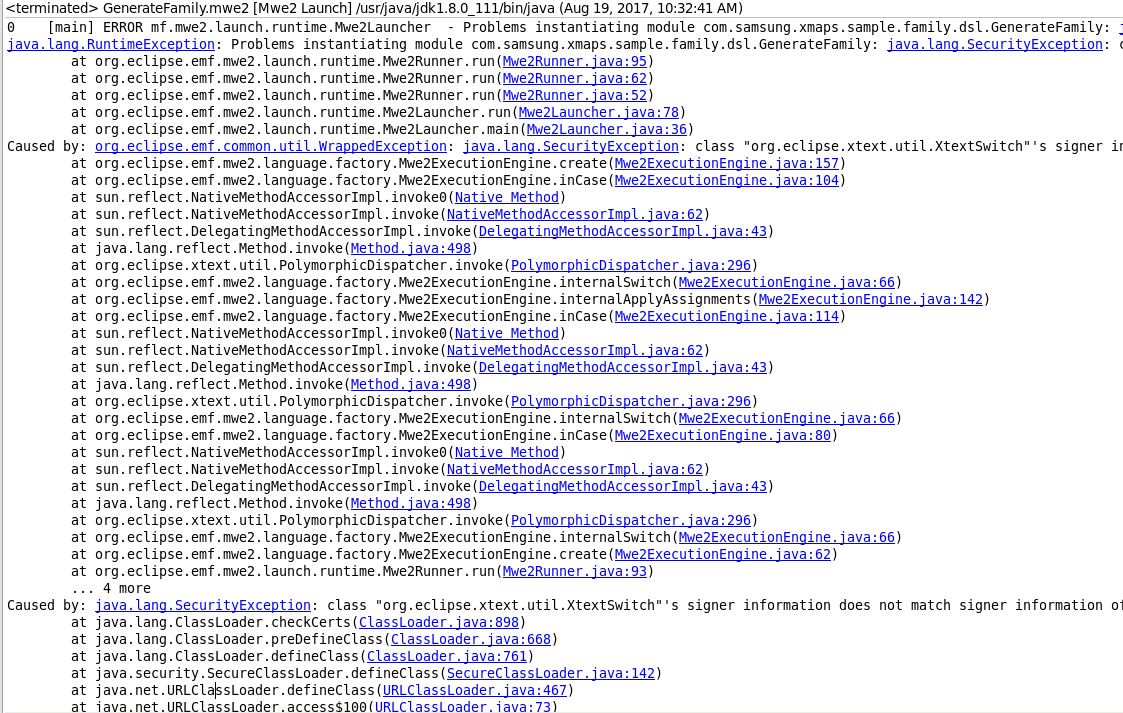

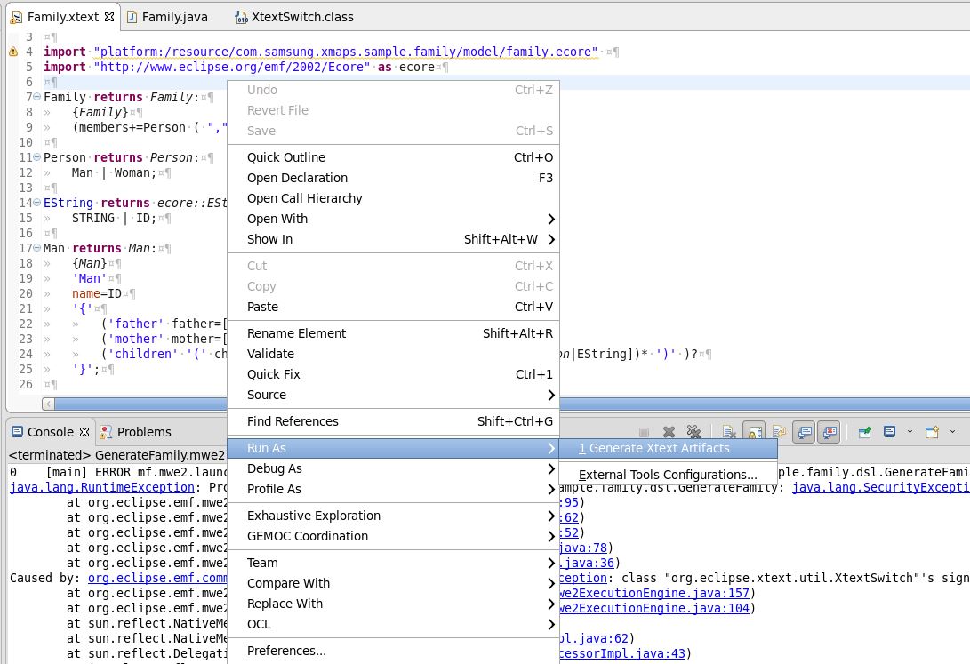

I met a problem when i use my modified xtext project to run "generate xtext artifacts" in a .xtext file. For details info please see the SecurityException.JPG, OperationCauseException.JPG and errormessage.txt.
index.php/fa/30417/0/
As my test, I use the pure xtext source code instead of my modified xtext code, it also has this problem.
only if I use the original org.eclipse.xtext_*.jar, it works.
The exception message shows "signer information does not match signer information of other classes in the same package". But I don't know where the signer information produced.
Can anybody help me?

Re: SecurityException when I use my modified org.eclipse.xtext to run "Generate Xtext Artifacts [message #1770945 is a reply to message #1770942] Sat, 19 August 2017 04:16 Go to previous messageGo to next message
what is the reason you patch at all?
did you patch both org.eclipse.xtext and org.eclipse.xtext.util bundle?
the signer information is in the manifests
