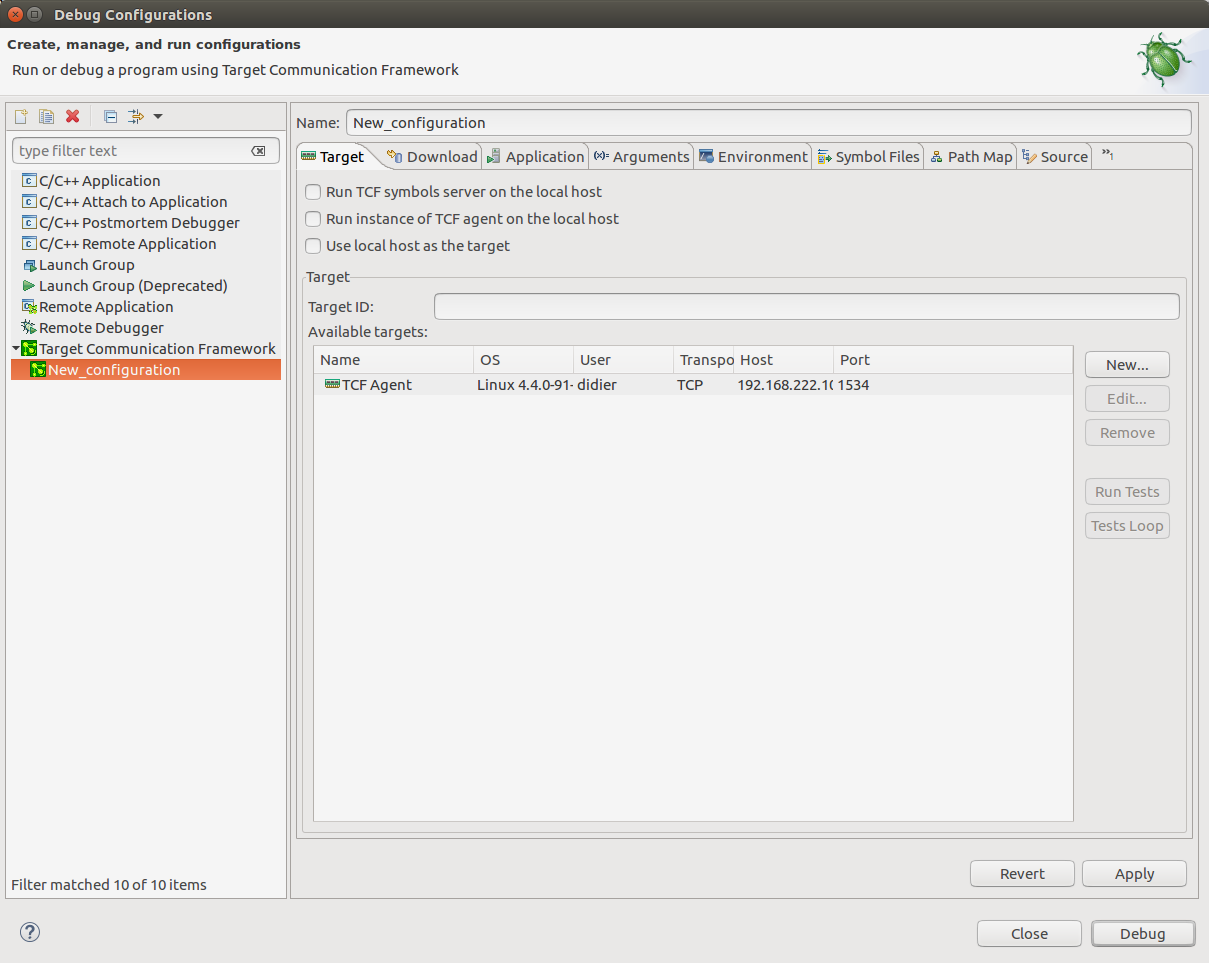

I am at a stopping point where I get this message:
Cannot find TCF agent on the local host
I can fix that if I have a clue WHERE / WHO is "local host " for "TCF agent" .
It means you are trying to connect to an agent running on your platform which is not what you want to do. Please, provide more details on which view you are using (sorry if it was specified in a previous email; I did not go through all of them).
First of all, you must start an agent on your ARM hardware.
Then, if you create a new TCF Debug session (Run -> Debug Configurations -> Target Communication Framework), then you should disable all the check-boxes ("Run TCF symbol server on the local host", "Run instasnce of TCF...", "Use local host as the target") and instead select the agent that appears under "Available Targets" if auto-discovery works or manually create the agent if it auto-discovery does not work (not on the same sub-network for example) by clicking on New and select "Manual setup of TCF connection properties" and update "Host" with the IP address of your ARM hardware.
The same comment applies, if you try to setup a new connection in "Remote Systems" view.

Your reply was very helpful, I appreciate that.
I got my sample code working , now doing some "reverse engineering" to find out how I can use it as a template for my project.
