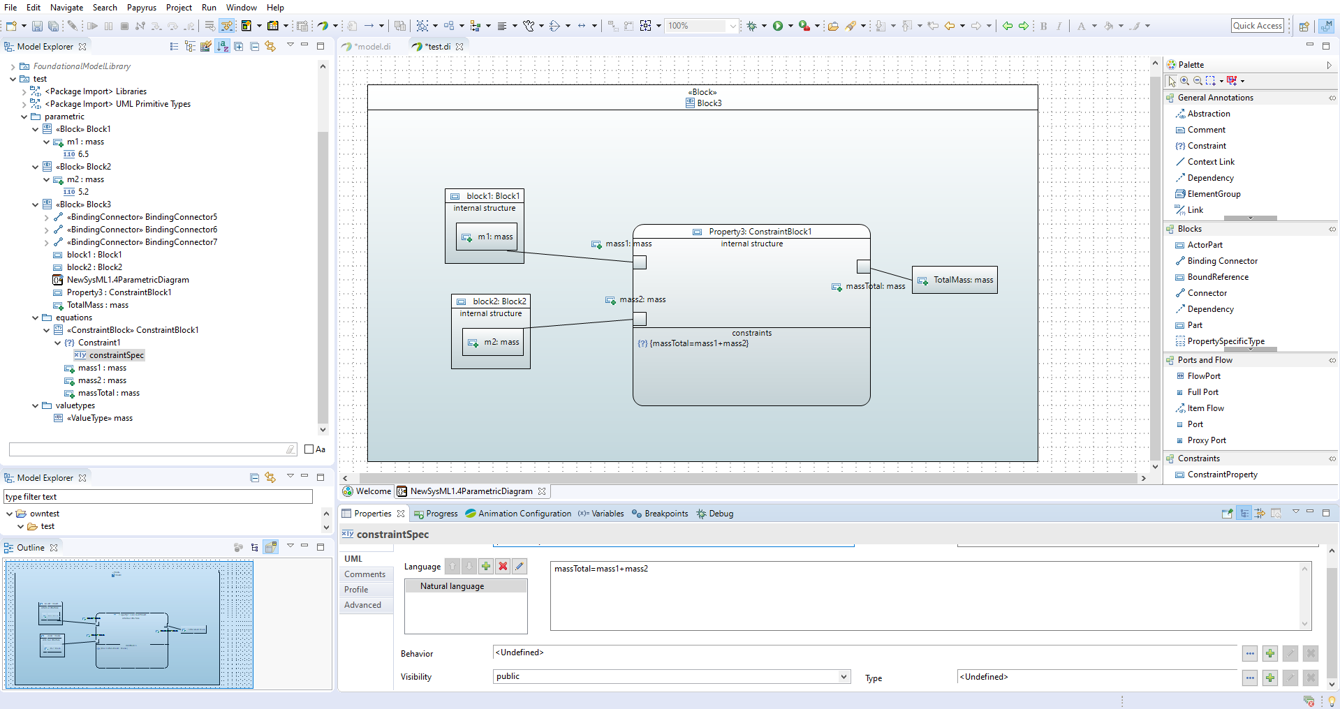

thanks for the explanations that you did above. I am also trying to create parametric diagrams in Papyrus but did not succeed so far. I just have a little experience with Papyrus and wonder if one needs to execute the model (MOKA?) to calculate something.
In my example I have two parameters (mass1 and mass2) which I would like to sum to receive the total mass in a third parameter. I am not sure how to define the constraint block and the equation (constraintSpec).
I attached a screenshot of my test-model.
In Cameo Systems Modeler it works easy. If one starts a simulation and changes the values of mass1 or mass2, the total mass will be calculated and shown as a runtime value in the console.
How does it work in Papyrus? Do I need to make MOKA running?
Can someone help me out? Any ideas?
Thanks for help and best regards! Lennox

Re: Need up to date instructions for SysML Parametric Modelling [message #1857833 is a reply to message #1857596] Tue, 28 February 2023 05:09 Go to previous messageGo to next message
Hi Pauline,
thanks for your answer.
First of all, do you think that I modelled correctly the declarative part to calculate the values (see my screenshot above)?
Second, I still have not succeeded to finally calculate the values (which normally should not be a difficult task). Is there any more documentation/tutorials besides the user guide?
Third, is there any possibility to run MOKA with the latest Eclipse Version instead of using Eclipse 2019-03? I got version conflicts when opening my models with Eclipse 2019...
Thanks for your help and best regards, Lennox
Re: Need up to date instructions for SysML Parametric Modelling [message #1857869 is a reply to message #1857833] Thu, 02 March 2023 11:34 Go to previous message
1. I am sorry am not an expert of this part and I don't really know how the simulation works for the composite. So I cannot say that it is wrong or not, I would say, I think that the behavior should not be describe as a constraint but may be with the classifier behavior of the class using an activity and using the FundationModelLibrary to have some basic operation like +/* ...
2. I don't know any other documentation
