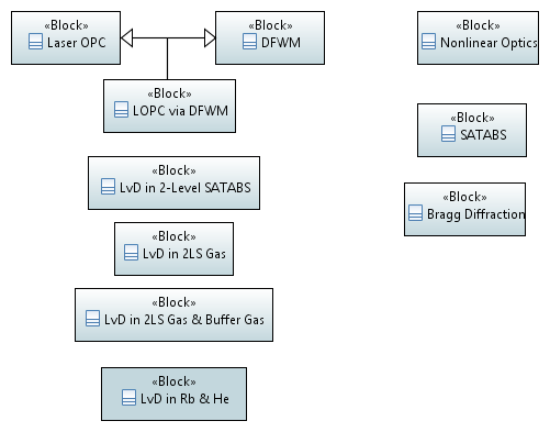

When I save a diagram image, the fill gradients for the diagram elements are wrong (compare the attached PNG and PDF). Is there something I should be doing differently?
Thanks!

I can reproduce this issue. It is likely caused by an issue in GMF, eventually similar to bug 327267.

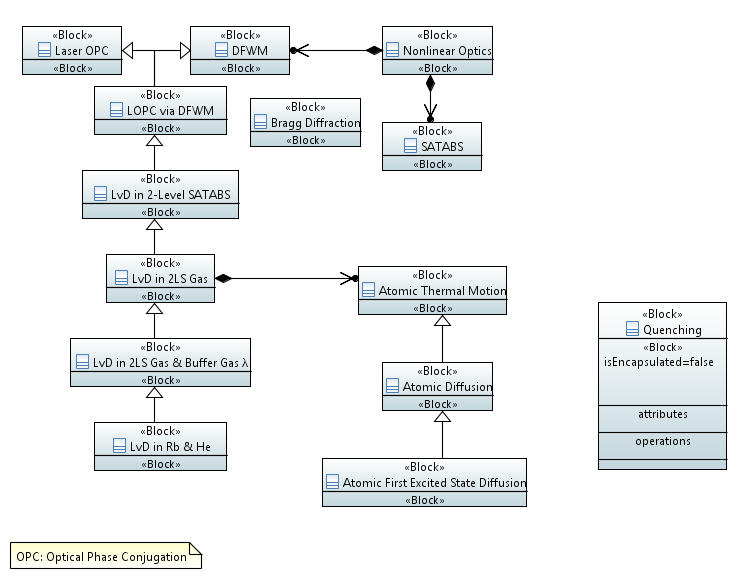

I'm only just now getting to return to this issue, but I can at this point attest to it being a consistent issue with the exportation of diagrams to PDF...and only PDF. I've attached more examples to prove the point.
I looked at the bug report, but couldn't quite trace the connection to this behavior (may well have been over my head). Am I the only person seeing this behavior?
Re: Save Diagram as Image File, PDF, gives incorrect fill gradients [message #1773118 is a reply to message #1773117] Thu, 21 September 2017 16:03 Go to previous message
Just to add to the fun, I have experimented some with changing the gradient settings on just one or another Block in the diagram.
--Horizontal Gradients seems to export just fine.
--A color change on a bottom Block gave the block a solid color, but no Gradient.
--A color change on a top Block did not show up at all in the exported image.
--Changing to Horizontal Gradient in a top Block works fine, but has no effect on the rest of the image.
