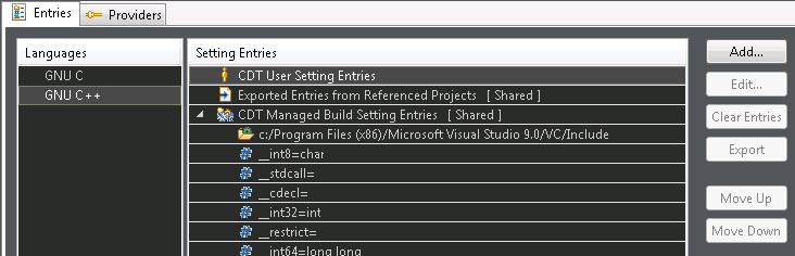

The indexer needs to be told where these files are located.
When using GCC, for example, you enable the compiler builtin discovery
Project --> Properties --> C/C++ General --> Preprocessor Include Paths, Macros etc. on the Providers tab.
This will then show builtins on the Entries tab.
I don't know of any way of getting this with VC.
You can run vcvarsall.bat in a command prompt window
then echo %VCINSTALLDIR%
the includes should be in %VCINSTALLDIR%\Include
You could add this as a User Entry on the Entries tab
I've been using the internal builder and the include directory is in the Managed Build settings.
These are discovered after a build.
I haven't been curious enough to determine what in particular the VC Tool Chain does.
