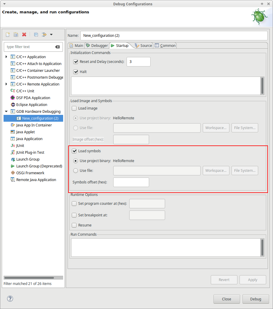

Are you using GDB Hardware Debugging (or C/C++ Remote Application). If you haven't used the GDB Hardware Debugging, I recommend it as it allows more customisation on launch/etc. In particular, if you provide the symbol file parameter in the configuration, that will mean the symbol table is loaded before the target remote is done:

This is the UI I am referring to:

I tried the GDB Hardware Debuging but not with much success. In the end they not succeeded because the arch was not set right. After the correct arch was set then they connect, but the breakpoints set from UI will not propagate to gdb, only the ones which you type by hand in the console are active. In mean time I recompiled the gdb to show version 7.0 instead and there was no improvement on my issue.
I was in the mindset that the new version is cause of this issues, but looks like they are present. Even when I converted workspace and used the same configuration the newer eclipse ignores the "C/C++ Application" file and the "Source Lookup Path" folders so they are not sent to gdb for some reason, and probably other issues cascade.
I'm mostly using the "C/C++ Attach to Application" because the "Remote applicacation" tries to start the gdbserver by it's own and use the serial/telnet or ssh to get there. But I don't have Linux nor any of these services available, the gdbserver is already running for me so the eclipse doesn't have to start it.

The description you are describing is exactly what GDB Hardware Debugging is for. However I can't quite follow exactly what went wrong when you tried that. Chip/board makers often ship additional Eclipse plug-ins that further customize the debugging experience to work with their boards/tools. Are you representing a manufacturer? I know a lot of companies are experimenting with riscv to figure out where they fit in the future landscape.
