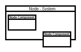

In my GEF5 project I am adding child nodes (Components) to a parent node (System).
I use TransformPolicy to enable drag and drop for my Component nodes.
Unfortunately I am able to drag Component nodes outside of the bounds of my System node (picture attached).
Is there some out-of-the-box functionality to prevent child nodes from beeing dragged outside the bounds of the parent node?

Hi Thomas,
there are multiple alternatives available for solving this issue:
A) Exchange child node part's TransformPolicy and prevent translation out of its parent's bounds, e.g. ParentRestrictedTransformPolicy. Then, you can bind it for all parts that should be restricted to their parent's bounds. No special code in the child parts is needed.
B) Override child node part's setVisualTransform() method and prevent translation out of its parent's bounds there. The ITransformableContentPart#setVisualTransform() method is called during interaction to apply the translation to the part's visual. The final visual transform (getVisualTransform()) is applied to the model using setContentTransform(). When choosing this alternative, you should probably factor out a RestrictToParentSupport that can simply be called.
Alternative B) is closer to your current status, so you can try it out easily. However, alternative A) allows for easier re-use, although a little more difficult to set-up.
Matthias

Hi Matthias,
thanks a lot, this is exactly what I needed!
Thomas
