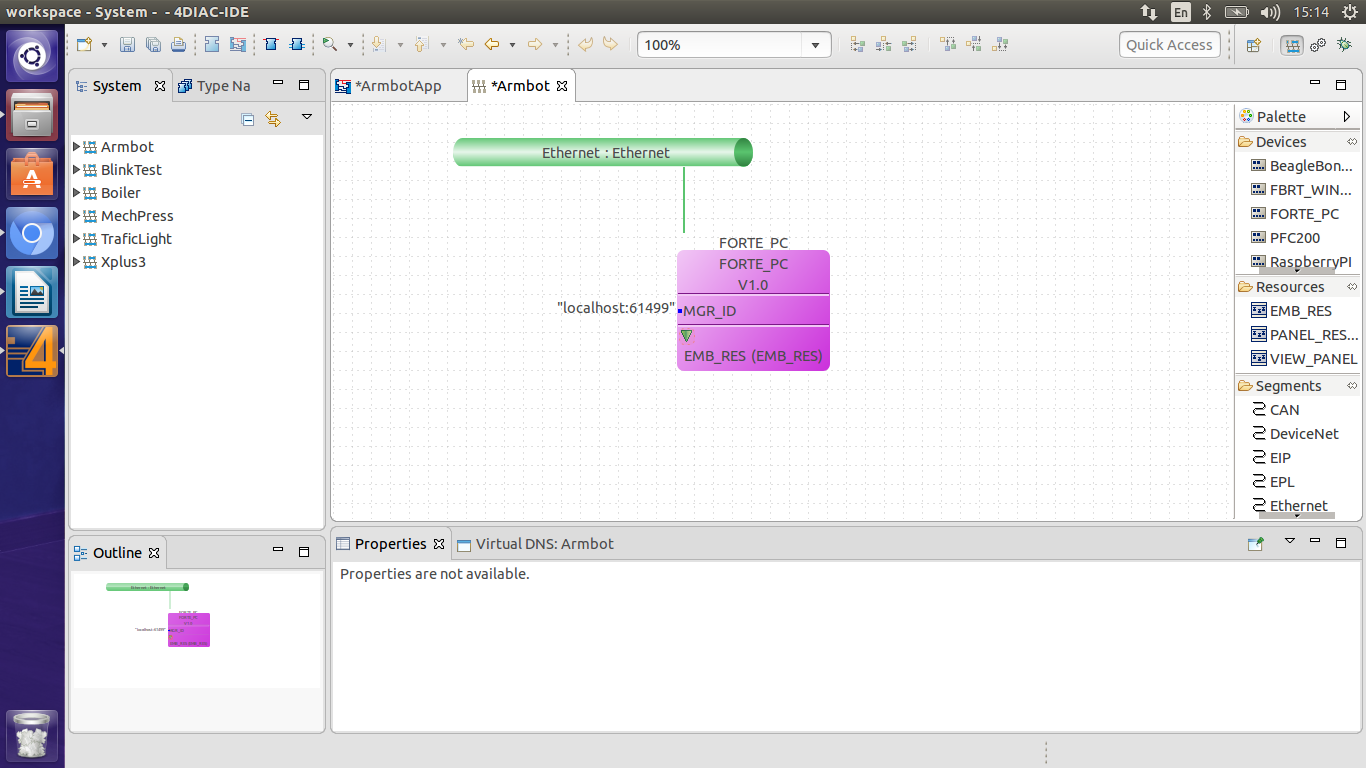

Hello, I am new to 4diac. I am trying to use function blocks to create a ros program, that will give movement commands to a robot. I have found this presentation
https://eclipse.org/4diac/uws/2016/UW_05_Eisenmenger.pdf
that helps a bit, to understand the integration, but I can't find more details anywhere. Can anyone help me?
  • Attachment: fgdfg.png
    (Size: 114.87KB, Downloaded 278 times)

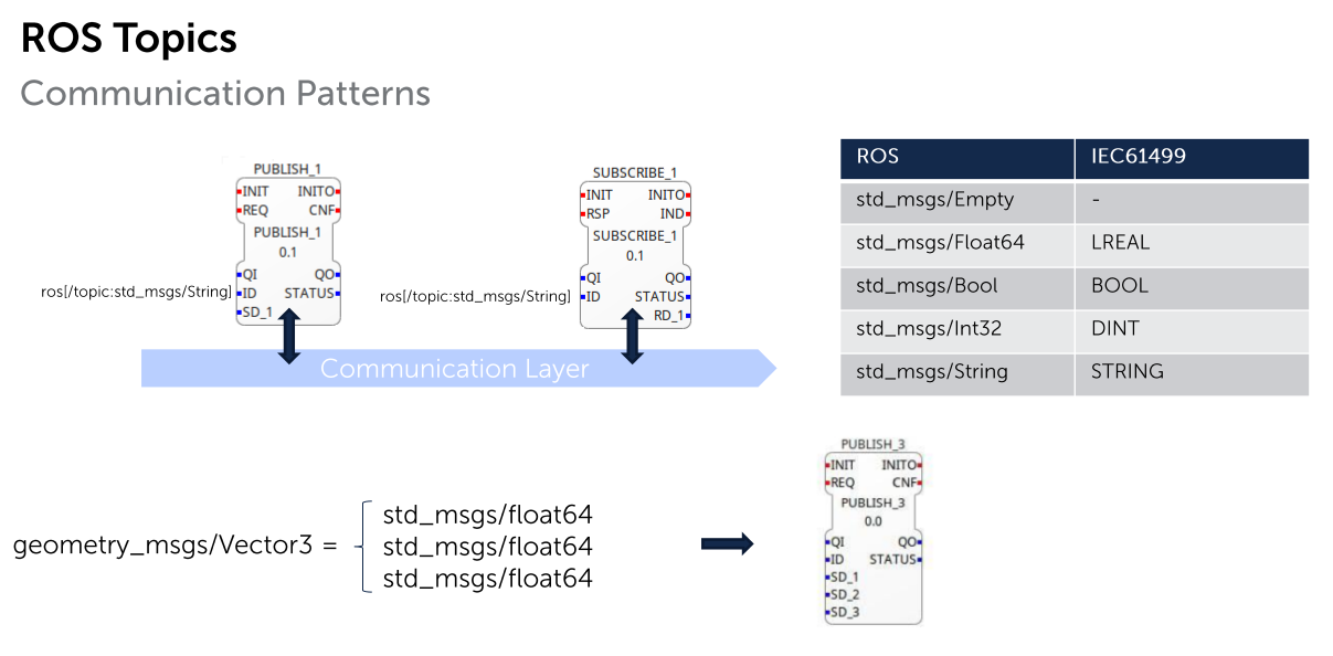

Re: Movement commands through 4diac [message #1770677 is a reply to message #1770431] Wed, 16 August 2017 04:08 Go to previous messageGo to next message
Hi Sofia,
I'm currently working on the documentation about 4diac's ROS communication interface.
The slide you mentioned shows the ROS datatypes that are currently supported by 4diac and the appropriate mapping to a IEC61499 (4diac) datatype.
Would you need other datatypes for your use case?

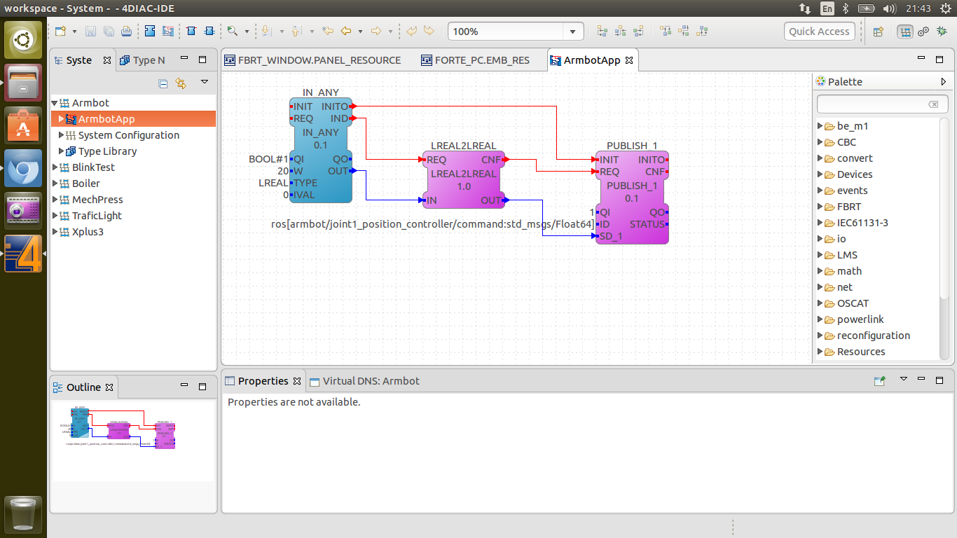

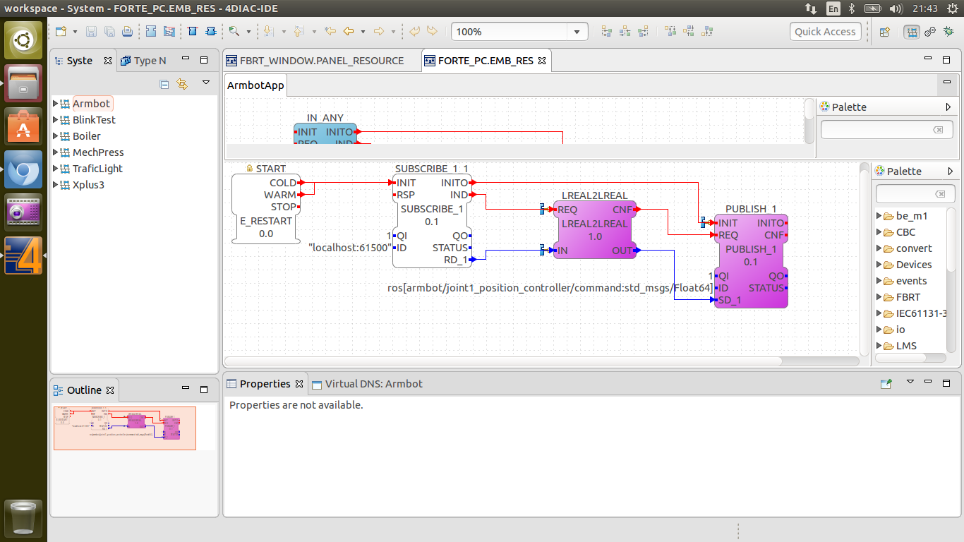

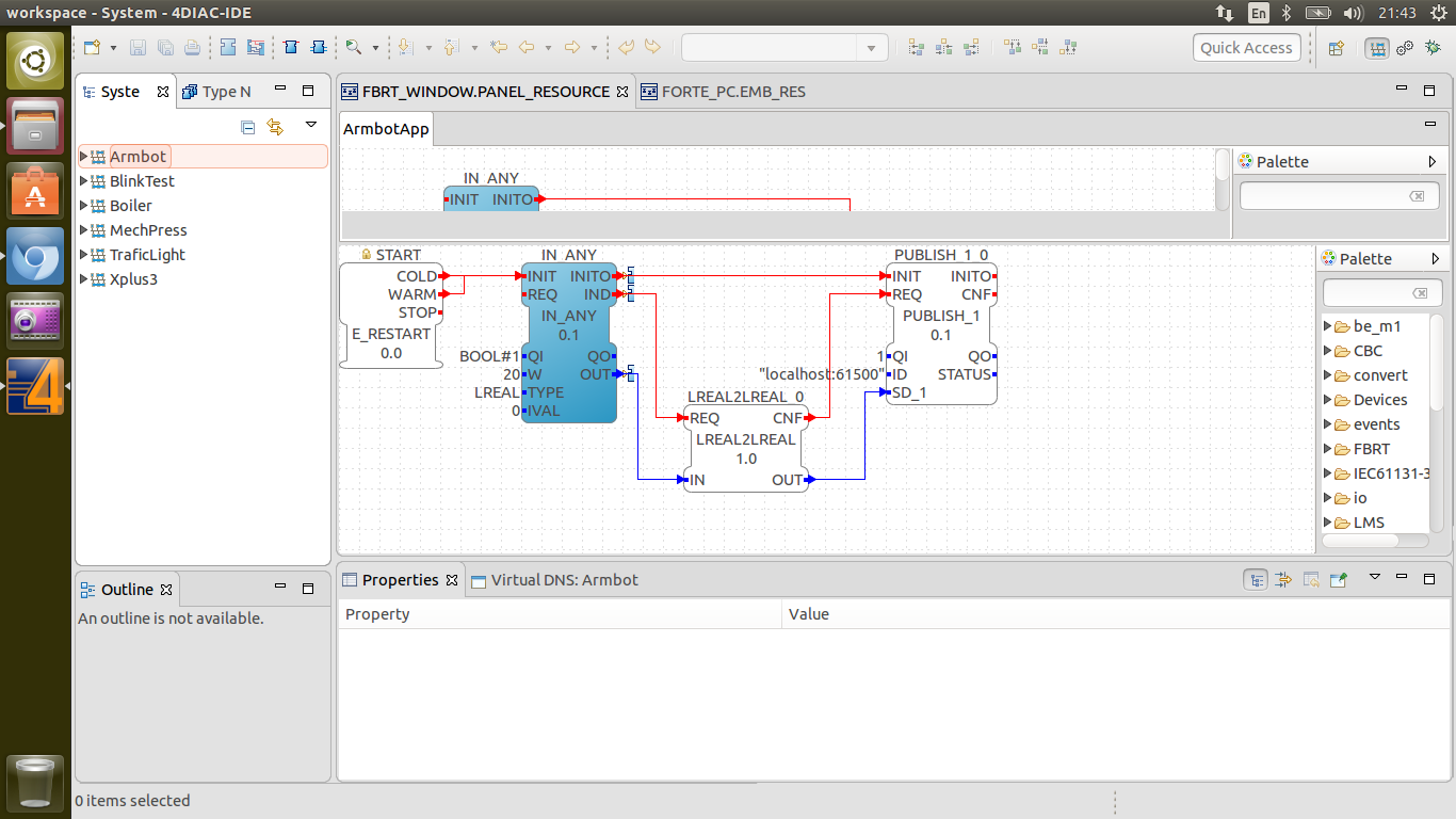

Re: Movement commands through 4diac [message #1774215 is a reply to message #1774209] Wed, 11 October 2017 14:46 Go to previous messageGo to next message
Not wet, I did some changes but I might be doing something wrong. I didn't have time to experiment with the application. I even tried to do a very simple one just by passing a value to a publish_1 fb but I can't find a fb that passes a specific value, as output data. Here is what my app looks for now.
  • Attachment: FORTE.png
    (Size: 167.93KB, Downloaded 215 times)
  • Attachment: FBRT.png
    (Size: 156.91KB, Downloaded 273 times)
  • Attachment: Application.png
    (Size: 171.01KB, Downloaded 335 times)
Re: Movement commands through 4diac [message #1774227 is a reply to message #1774215] Wed, 11 October 2017 16:12 Go to previous messageGo to next message
have you tried to use 4diac's monitoring feature to see the interface values? If you get the bind error messages as shown in above it means that there is already a forte running. Here it would be good to check that no other forte instance is running in the background.
Re: Movement commands through 4diac [message #1774263 is a reply to message #1774227] Thu, 12 October 2017 07:03 Go to previous messageGo to next message
I had to change "localhost" and "ros" to myIP:something. Now The publish function block gets the LREAL number I want to pass as "std_msgs/Float64", but QO is False, and STATUS is NO_SOCKET. I am running both programs at the same computer.
