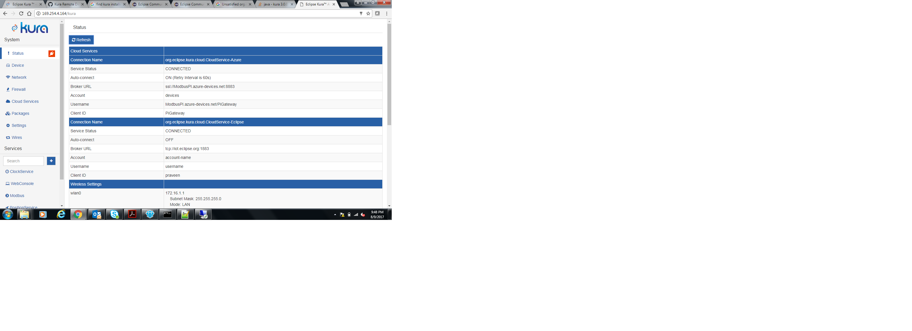

Re: Kura on Raspberry PI - Remote management is not working [message #1770236 is a reply to message #1770235] Wed, 09 August 2017 05:56 Go to previous messageGo to next message
could you post a screenshot of the current cloud service instances you have?
Matteo
Re: Kura on Raspberry PI - Remote management is not working [message #1770288 is a reply to message #1770236] Wed, 09 August 2017 12:25 Go to previous messageGo to next message
Hi Matteo,
I configured two cloud services. One with Azure IoT Hub and another with IoT.Eclipse. Both connections are established properly.
Please find attached screenshot.
WIth Best Regards,
Praveen.B
  • Attachment: kuraerror.png
    (Size: 167.11KB, Downloaded 122 times)
Re: Kura on Raspberry PI - Remote management is not working [message #1770299 is a reply to message #1770288] Wed, 09 August 2017 14:26 Go to previous messageGo to next message
that's the point: the deployV2 is strictly related to the default cloud service.
Here the reference that should be matched: CloudService.target = (kura.service.pid=org.eclipse.kura.cloud.CloudService)
Best regards
