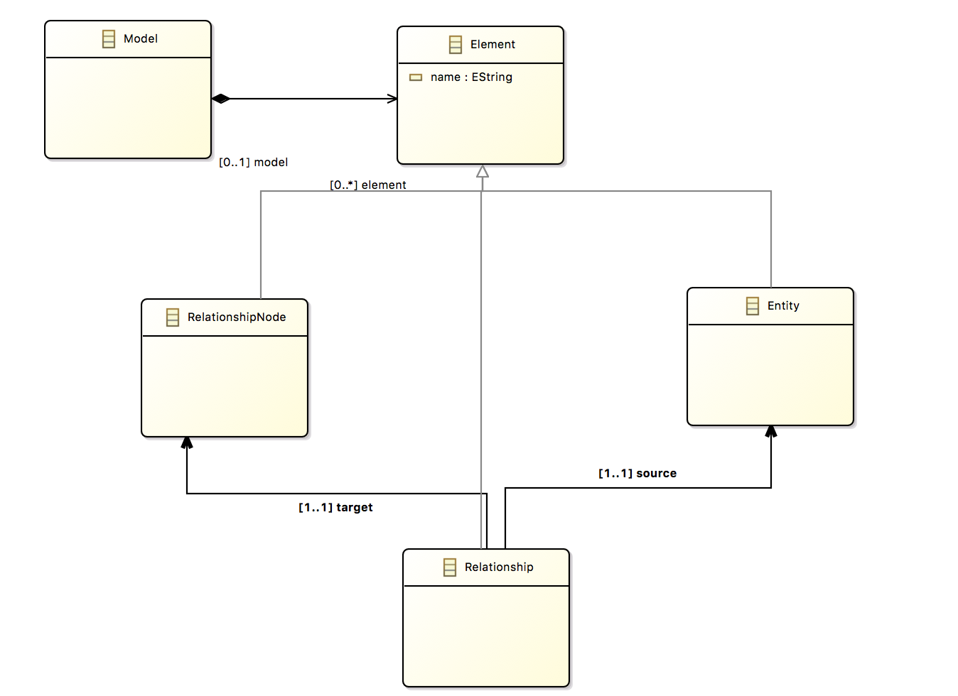

I think that it might be a better question for me to ask when an edge gets deleted from the model? Shouldn't it be deleted as soon as the source/target gets deleted? If not, how would I go around deleting it?
Let me simplify this by asking it about a simpler version of the metamodel as in the picture:
When a RelationshipNode (target) or Entity (source) gets deleted, the Relationship is also automatically deleted.
Thank you very much for your help.
Kind regards,
Sonny

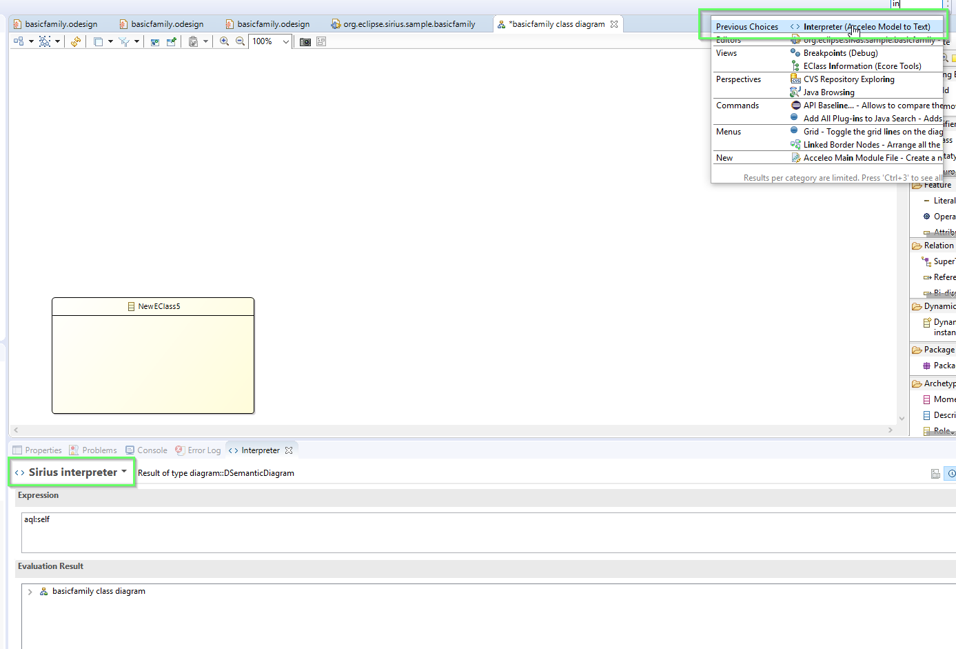

To help you you can use the Sirius interpreter view:
index.php/fa/30364/0/
If the result is not your relationship then your wrong.

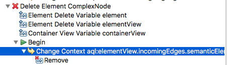

Re: Edge delete on Element deletion [message #1770561 is a reply to message #1770548] Mon, 14 August 2017 08:49 Go to previous messageGo to next message
Dear,
First of all, I wish that I knew how the interpreter worked when I began with developing my tool, it would have helped me a lot. It might be a good idea to incorporate it in the documentation of AQL or one of the tutorials.
That said, I have found the elements to which I am referring with the following statement: aql:self.incomingEdges.semanticElements
Now, when I incorporate it in my design, it doesn't delete the elements, what would I be doing wrong?
index.php/fa/30366/0/
I hope this gets to you in time.
Kind regards,
Sonny Selhorst
Re: Edge delete on Element deletion [message #1770563 is a reply to message #1770561] Mon, 14 August 2017 09:22 Go to previous messageGo to next message
your expression returns all semantic elements of all incoming edges. Remove applies on one element not on a list. So you should have a for loop with aql:self as expression and the remove inside.

You also can use the sirius interpreter on your model opened with default ecore editor.
For the documentation part, the interpreter is described in https://www.eclipse.org/sirius/doc/specifier/general/Writing_Queries.html#general
But it could have its own title I agree.
For the tutorial part, yes it could also be good to have it inside. I will spread the word. Thanks for feedback

Re: Edge delete on Element deletion [message #1770638 is a reply to message #1770563] Tue, 15 August 2017 09:31 Go to previous message
Dear Pierre,
Thank you very much for all the help. It has worked by using a for loop that selects the correct edges and deletes them.
