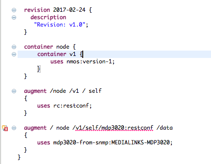

Re: implement Xpath using Xtext [message #1770533 is a reply to message #1770526] Mon, 14 August 2017 02:46 Go to previous messageGo to next message
Hi Christian,
I have fixed my errors but now I am getting a new error.
I can import the schema node for my augment statement but I cannot get the perfect output.
I am getting this output with my current grammar.
  revision 2017-02-24 {
    description
     "Revision: v1.0";
  container node {
	  container v1 {
		  uses nmos:version-1;
  augment node /v1 /self                           //(Error)
	  uses rc:restconf;
  augment / node / v1 / self / mdp3020:restconf / data                   //(Error)
	  uses mdp3020-from-snmp:MEDIALINKS-MDP3020;

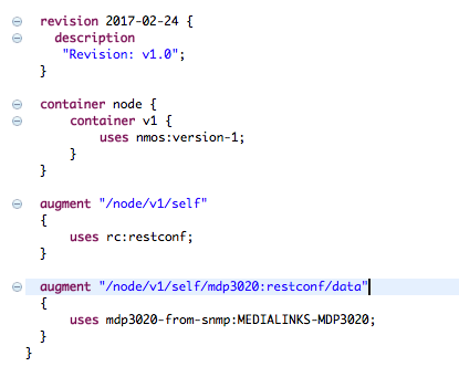

This is what I want. Check the AugmentStatement. I need ( " " ) and i do not want any white space between two slashes(/). I also want few prefix statements wherever we need in nodes like (mdp3020:restconf).
    description
     "Revision: v1.0";
  container node {
	  container v1 {
  augment "/node/v1/self"                 //(correct output)
	  uses rc:restconf;
  augment "/node/v1/self/mdp3020:restconf/data"      //(correct output)
This is my current grammar.
ContainerStatement:
	'container' name=STRINGARG  (';' | '{'
		(containersubstatements+= ContainerSubStatement)*
ContainerSubStatement:
	ConfigStatement |
	ContainerStatement |
	LeafStatement |
	ListStatement |
	LeafListStatement |
	DescriptionStatement |
	UsesStatement |
	UnknownStatement
AugmentStatement:
	'augment' path= SchemaNodeIdentifier
		(augmentsubstatements+= AugmentSubStatement)*
AugmentSubStatement:
	LeafStatement |
	LeafListStatement |
	UsesStatement |
	StatusStatement |
	UnknownStatement
 SchemaNodeIdentifier returns SchemaNodeIdentifier:
	'"' RootSchemaNodeIdentifier ({SchemaNodeIdentifier.target=current}'/'schemaNode=[ContainerStatement|QName])* '"'
RootSchemaNodeIdentifier returns SchemaNodeIdentifier:
	isAbsolute?='/'? schemaNode=[ContainerStatement|QName]

Hi Christian,
I do not have any ambiguities in my grammar at the moment.
As i told you, the problem is whitespace between two nodes.
Here is the grammar for my problem:
AugmentStatement:
	LeafStatement |
	LeafListStatement |
	UsesStatement |
	StatusStatement |
	UnknownStatement
	 RootSchemaNodeIdentifier ({SchemaNodeIdentifier.target=current}'/'(schemaNode=[ContainerStatement|QName]))*
This is my errors:
index.php/fa/30400/0/
This is what i need in augment.
index.php/fa/30401/0/

Multiple markers at this line
- Couldn't resolve reference to ContainerStatement 'v1'.
- Couldn't resolve reference to ContainerStatement 'self'.
- Couldn't resolve reference to ContainerStatement 'mdp3020:restconf'.
- Couldn't resolve reference to ContainerStatement 'data'.
=> scoping

I am getting these errors:
>Couldn't resolve reference to ContainerStatement '"/node/v1/self"'.
>Couldn't resolve reference to ContainerStatement '"/node/v1/self/mdp3020:restconf/data"'.
I need this output with my current grammar.
	  uses rc:restconf;

This is my xtext grammar for the firstpart+ ":"+ secondpart.
	 RootSchemaNodeIdentifier ({SchemaNodeIdentifier.target=current}'/'((prefix=STRINGARG':')? schemaNode=[ContainerStatement]))*
	isAbsolute?='/'? ((prefix=STRINGARG':')?schemaNode=[ContainerStatement])
The first part is a prefix which i am writing as a string but for the second part, I am using cross-reference as you can see in the above grammar.
I made some changes to fix the problem. But still could not able implement the valid output.
