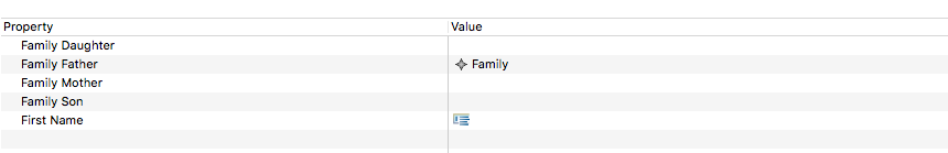

When I create an instance of "Families" metamodel, It is not possible to e.g., a Member be both (Family) mother and (Family) father or mother and daughter or etc. I want to know which property in its metamodel causes that?
I attached the metamodel and the model.

All the references of Family are containment references. Any instance can only be in at most one containment reference; adding an instance to a containment reference will remove it from any other containment reference where it's currently contained.

It is very unfortunate that the families and Families2Persons transformation have become standard intro examples.
The containment perverseness of the Families model is very confusing. (There is no actual specification, so it isn't actually a bug; just an offense against common sense.)
