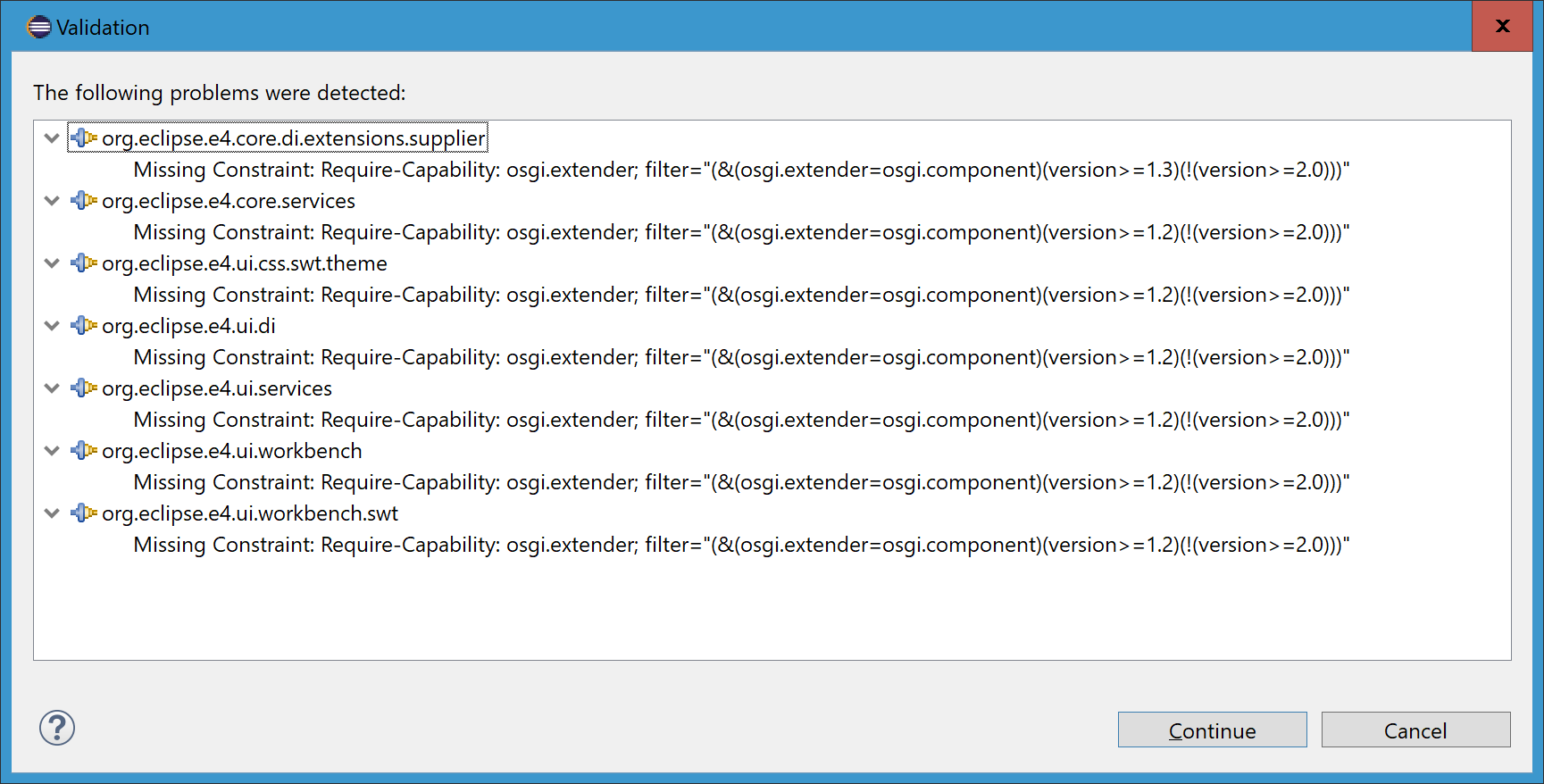

I created the .product file and it looks OK as far as I can tell, but when I try to run this "product" (using the "Launch an eclipse application" link in the Overview tab) all I get is a popup that there are 7 constraints that are not satisfied - see screenshot. :-(
Any guidance what I am missing here and what is needed to get this fixed and running?

It's a pretty confusing message! You're missing the `org.eclipse.equinox.ds` bundle which provides the OSGi Declarative Services. The general recommendation is to use a feature-based product, such that you can include the `org.eclipse.e4.rcp` feature. Otherwise carefully ensure that you have all of the bundles referenced from the `org.eclipse.e4.rcp` feature.
Brian.
