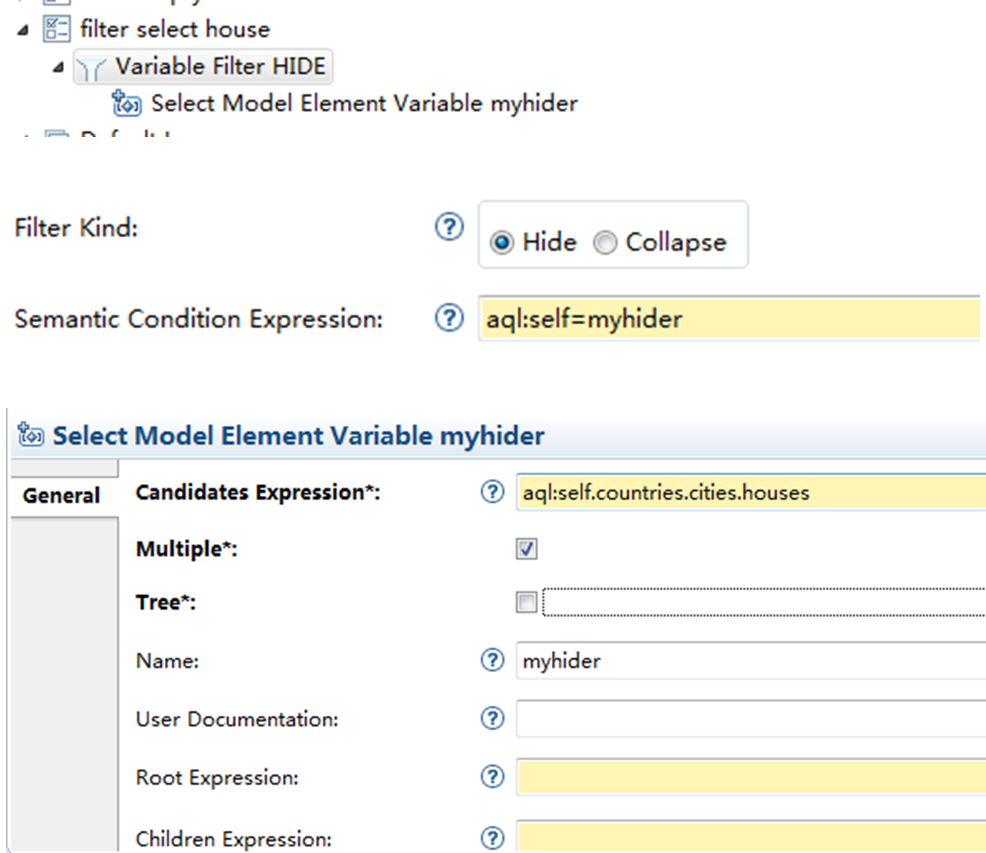

1. I define a variable filter and use 'Select Model Variable'
index.php/fa/30259/0/

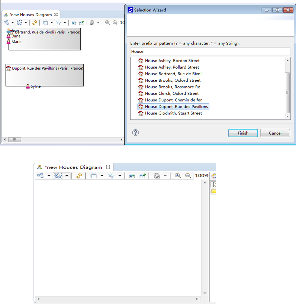

When I run the filter, all the Houses are disappear, what I want is just hide the family that I selected.

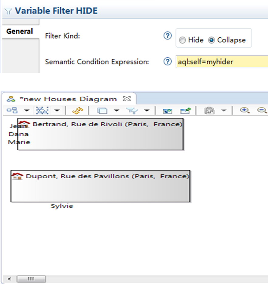

2. When I define the 'Filter Kind' to Collapse. All the Bordered Node are collapsed. It's very strange.

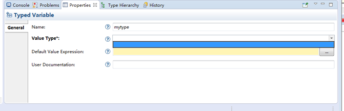

3. Otherwise, when I define a 'Typed Variable', I can't set the 'Value Type' like the document descripts (http://www.eclipse.org/sirius/doc/specifier/diagrams/Diagrams.html#variable_filter).

Re: Question about Variable Filter [message #1769848 is a reply to message #1769784] Fri, 04 August 2017 03:45 Go to previous messageGo to next message
The solution is the first but the expression must be something like
 aql:not myhider->includes(self)
regards,
Laurent
Re: Question about Variable Filter [message #1769852 is a reply to message #1769848] Fri, 04 August 2017 04:32 Go to previous message
Laurent Redor wrote on Fri, 04 August 2017 15:45
regards,
Laurent
Thank you very much, it works as you said.
