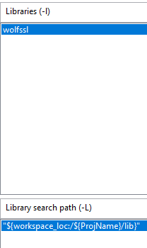

I tried the following:
Added library path to the C linker -L: ${workspace_loc:/${ProjName}/lib}
Added library name to -l : wolfssl where the library name is libwolfssl.a

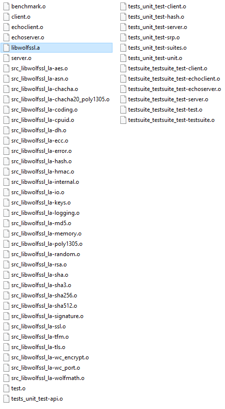

I collected all the object files that "make" command generate as per the above image attached
index.php/fa/30269/0/
I executed the comman "ar" to create a static library out of those files and I called it libwolfsll.a

The above images shows how I added this library to Eclipse

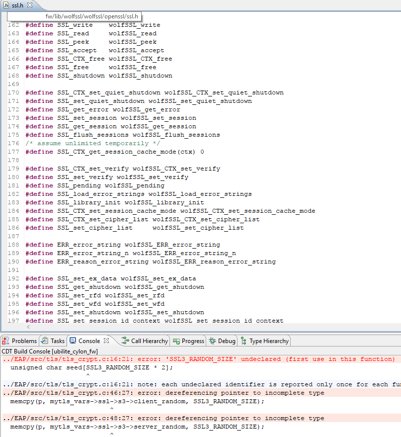

index.php/fa/30270/0/
The SSL functions I need to call are in the file shown in this image, I tried to #include it in the fine tls_funcs.c that needs to call them but I am getting many errors that they are not declared as if the library is not there at all.

The first error is saying there is no definition for SSL3_RANDOM_SIZE.
The second and third are saying that what ssl is pointing toward is declared only as a forward declaration such as "struct ssl_;" .
I would think that the build had stopped before reaching the link stage so your questions about linking the library appear premature.
You should fix the depicted problems first.
Your post suggests a misunderstanding of what is going on.
The -L,-l are options telling the linker where to find the compiled functions which have been collected into an archive.
The compiler is interested only in the interface to those functions.
These are usually specified in an included header (.h) file.
The header file you used appears incomplete.
