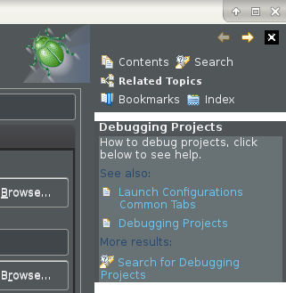

For me, the "?" button on a Run/Debug Configuration dialog shows:
index.php/fa/30241/0/
And selecting the first option (Launch Configurations Common Tabs)
Brings up the above linked help text
If it doesn't for some reason, use one of the two links above.

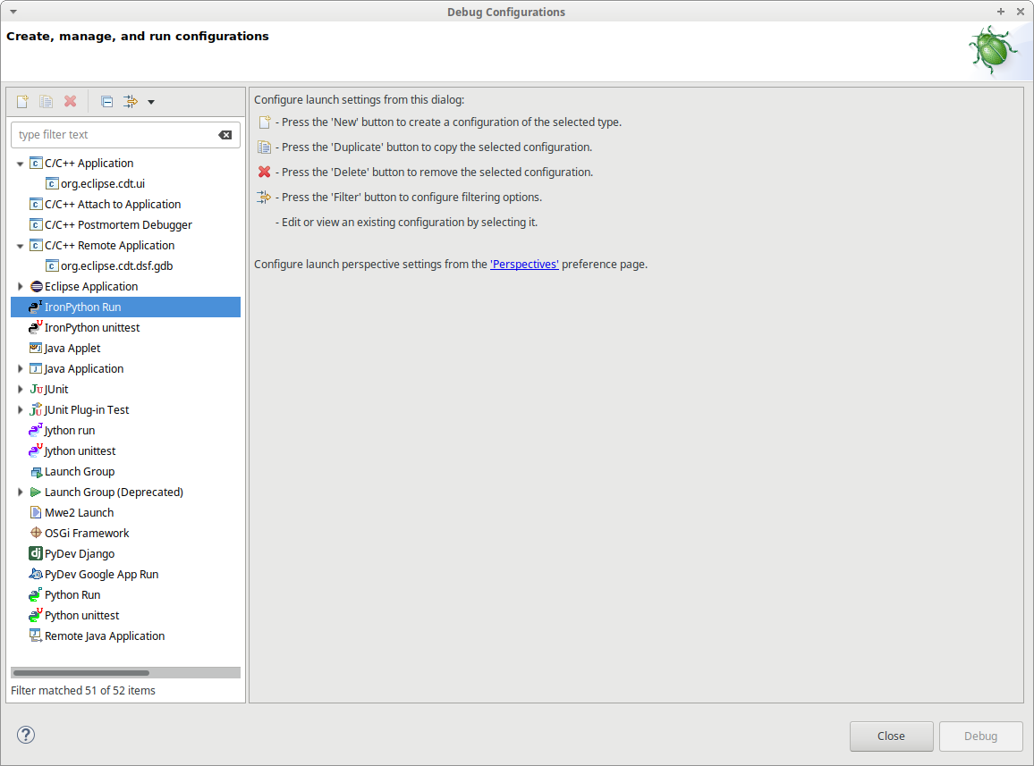

Here is a Ubuntu screenshot.
index.php/fa/30277/0/
BTW I am really having a lot of trouble understanding what your problem is.
I'll try to describe it as best I can , without pictures.
Sometimes pictures can save a 1000 words, put in a picture!
