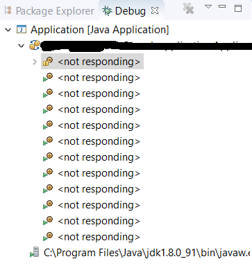

I put breakpoints on "ComputationException" and "StackOverflowError" and thought of tracing back to find the types that Guice is trying to build/bind, but the debugger gets stuck/stops responding (PS attached image). Is there a better place to put the breakpoint(s) ?

  • Attachment: 037.png
    (Size: 11.53KB, Downloaded 101 times)
