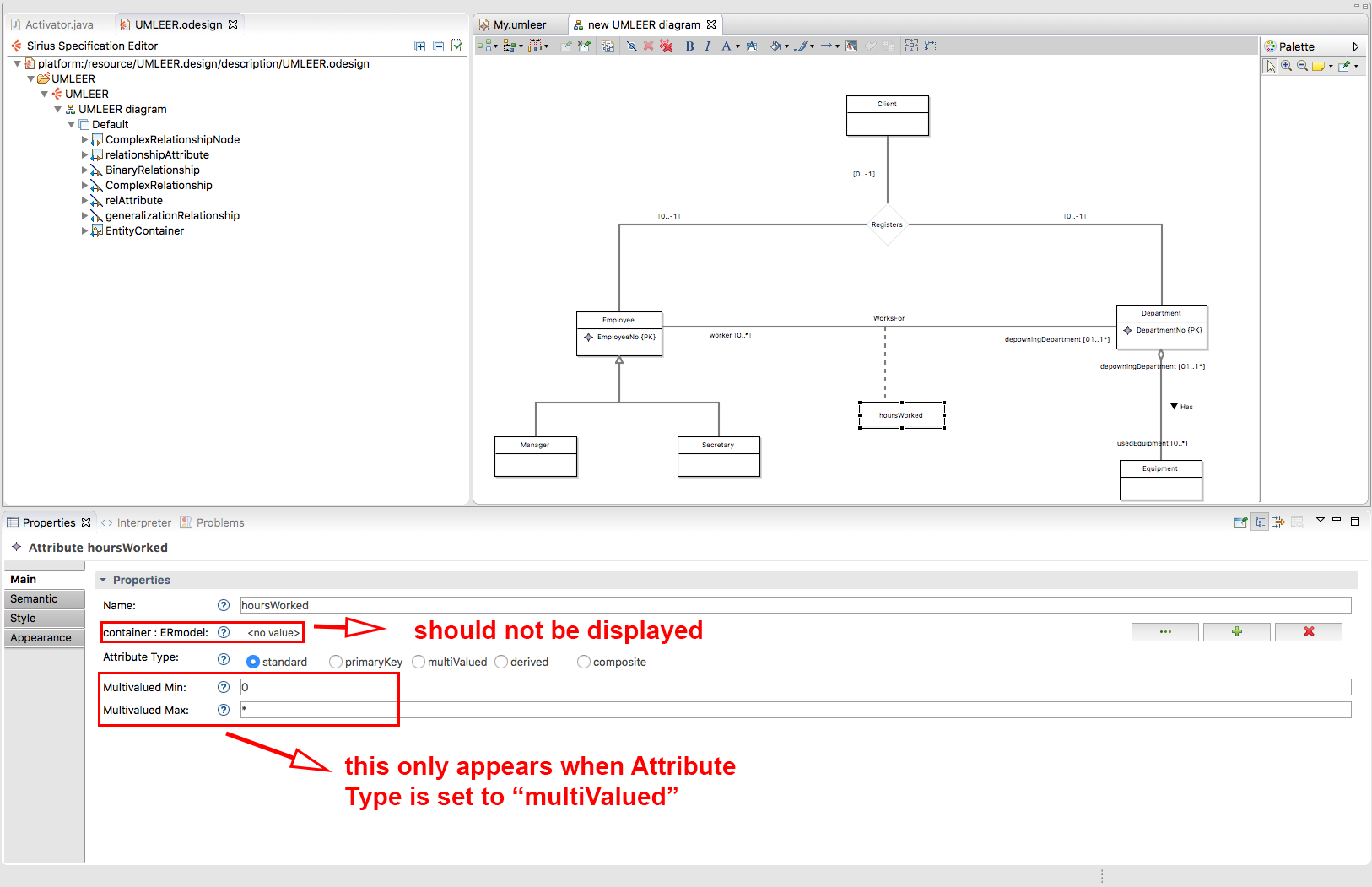

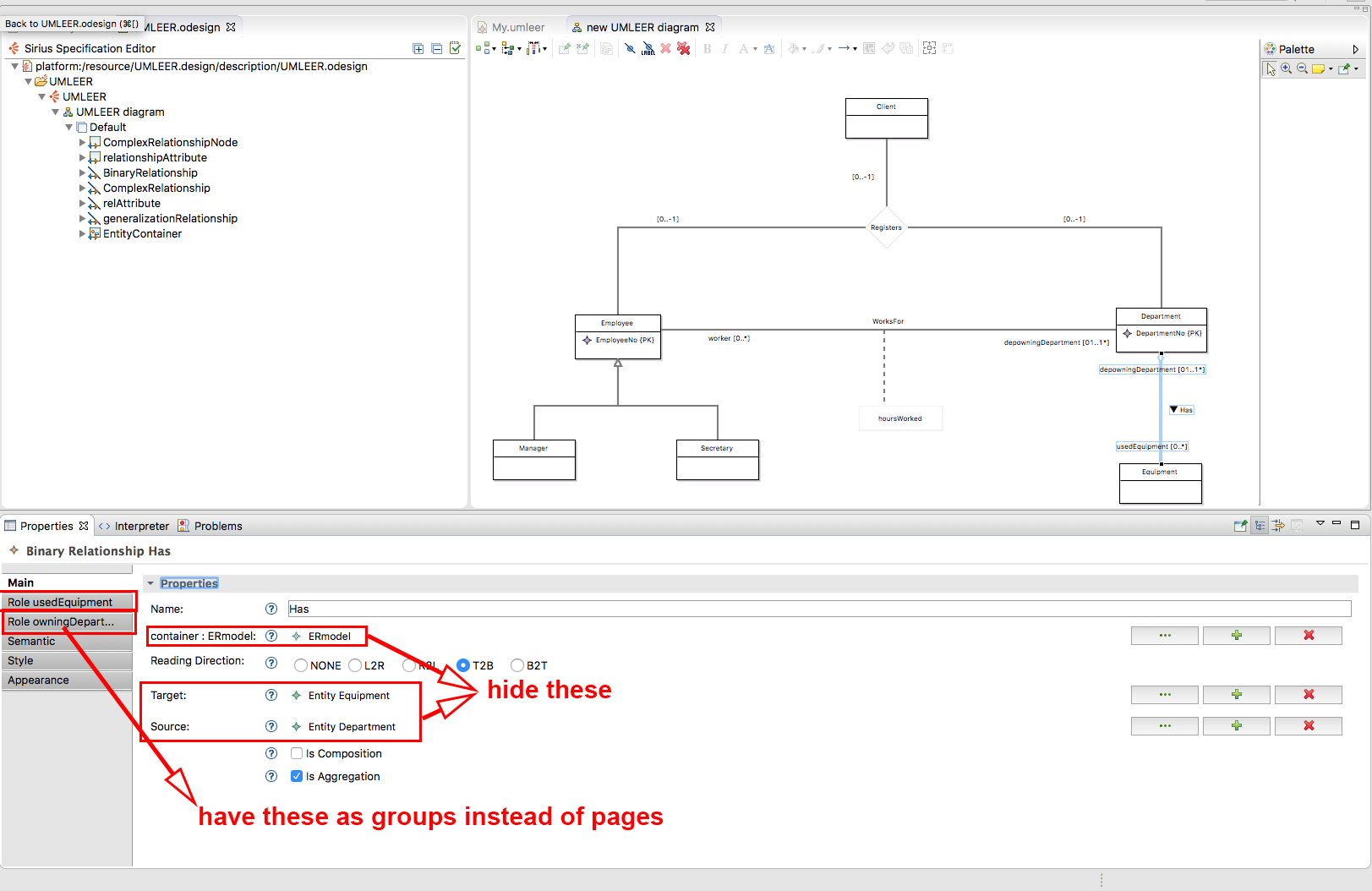

Dear,
Thank you very much for your quick response, it helps me a lot.
I had read the documentation and experimented with it, but I can't seem to be able to grasp it completely. I think I need to apply filters in the "Extends" page, but I don't really know what to type in there. I thought that maybe there would be an option to have all properties displayed in a treelike editor, so that I could easily edit/delete them.
In the images you can see two examples of properties views and what I would want to delete/change in it.
Again, excuse me if this is due to my lack of knowledge, I am not trying to be lazy.
  • Attachment: example1.png
    (Size: 182.45KB, Downloaded 168 times)
  • Attachment: example2.png
    (Size: 170.67KB, Downloaded 144 times)

There are basically two approaches:
* Create a local copy of the default rules, and tweak them. On the VSM's top-level Group element, select New Properties > Import Default Properties view. This will create a copy of the model used by Sirius for the default rules inside your own VSM, as if you had created them manually. You can then tweak them however you want. The drawback is that this is a fixed copy of the default rules at the time of import, so any change or improvement in the default rules in future versions of Sirius will not apply (in practice this should not be an issue).
* Keep using the implicit default rules provided by Sirius, but create local overrides (see https://www.eclipse.org/sirius/doc/specifier/properties/Properties_View_Description.html#overrides), which will be applied at runtime. You can think of override a little like patches applied at runtime to change specific parts of a properties definition model. Often an override will also *extend* an existing element, for example a Page Override can say "I override (replace) the Page Definition X, and extend X (so that by default all definitions in X are inherited) with this and this additional elements (defined inside the override). I also want to hide elements Y and Z that I inherited from X (this is configured using filter expressions)."
