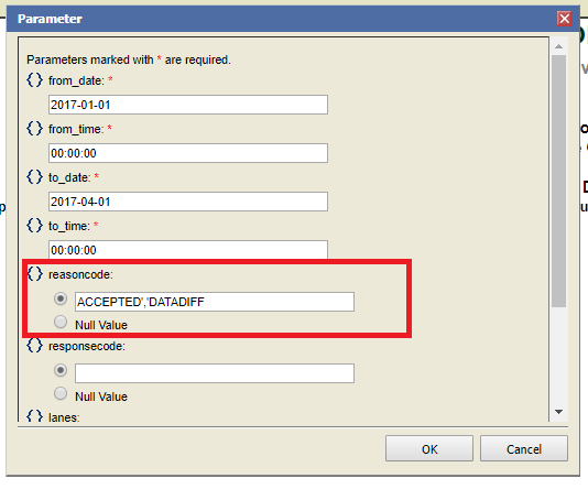

If I pass one value it is working fine, When I try to send multiple values to IN operator I am not getting data.
index.php/fa/30203/0/
When I send single value ACCEPTED it is working, When I send like below manner it is not working. i tried in multiple ways like below :
ACCEPTED','DATADIFF
'ACCEPTED','DATADIFF'
"ACCEPTED','DATADIFF"
How can I send multiple values to in operator?(and a.ReasonCode in (?))

Re: How to Pass multiple values to SQL query of IN operator through BIRT REPORT params? [message #1790946 is a reply to message #1769428] Wed, 20 June 2018 08:53 Go to previous message
On the property binding page add the sql - it will replace the sql from your query.
It's kind of a mess. You have to create the set with parens and include the single quotes around your dynamic params.
Select fieldname from table where whatever in "(" + "'"+params["param1"]"', ' " + params["param2"] + "'
It should be noted their is no way to do this dynamically for a multi-value parameter. Really pretty stupid this is missing. BIRT will even warn you that it won't work. if you hook a multi-valued param into the query.
I am still holding out that I can use javascript to parse the multi-value param which looks like this from a combo box [VAL1, VAL2]. I want to swap the brackets for parans and add single quotes around the values.
