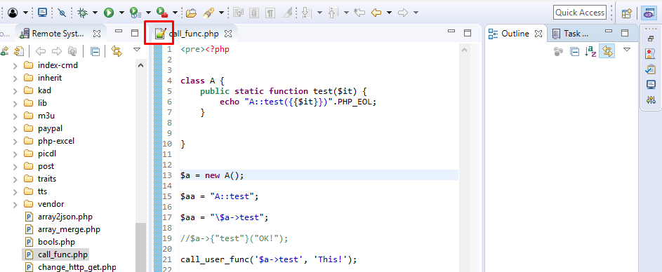

Same problem here. Eclipse PDT Outline is empty when opening files using Remote Systems.
One more strange thing is that the tab icons have changed! For example, I see the usual icon for php files with a "P" inside a document at the Remote Systems Explorer, but at the tab of an opened php file I see the system icon, which in my case is from Notepad++!
index.php/fa/30322/0/
I will stick back to Neon 3 until this gets fixed.
UPDATE
After some investigation, I realize that PDT has to have a PHP Project to show the outline contents. Well, I'm using Eclipse for many years, and I can't remember that would have to create Project/Remote Project in order for outline to be filled. It's working directly without o project when opening files from RSE to Neon 3 and older versions.
