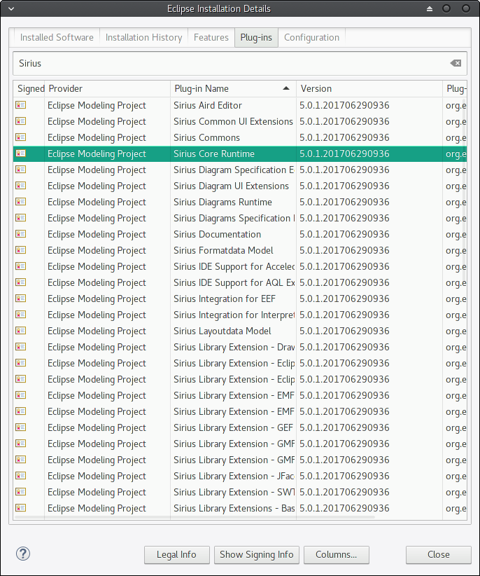

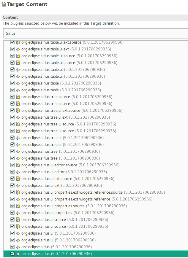

I am new to Sirius and I have an beginner Problem with my RCP. I create an new Projekt with an .design plugin and all the other parts. Then I edit the *.odesign file and save it. After this I start my RCP and this error Message is throwing:
The viewpoint specification model (platform:/plugin/test.projectmodel.design/description/projectmodel.odesign) can not be loaded because it comes from a more recent Sirius release.
VSM version is: 12.0.0.2017041100
Last Sirius migration version is: 12.0.0.201704030900
So I open the .odesign file and see that there is this version attribute.
<description:Group xmi:version="2.0" xmlns:xmi="http://www.omg.org/XMI" xmlns:xsi="http://www.w3.org/2001/XMLSchema-instance" xmlns:description="http://www.eclipse.org/sirius/description/1.1.0" xmlns:description_1="http://www.eclipse.org/sirius/diagram/description/1.1.0" xmlns:style="http://www.eclipse.org/sirius/diagram/description/style/1.1.0" xmlns:tool="http://www.eclipse.org/sirius/diagram/description/tool/1.1.0" name="projectmodel" version="12.0.0.2017041100">
I change the version to 12.0.0.201704030900 and start my RCP again. And it work all fine. But Every time i edit the file the version attribute is setting back to: 12.0.0.2017041100
I try to setup my Eclipse IDE new and check my target Platform version, both are on the same version 5.0.1.201706290936. You can see it on the Images
index.php/fa/30145/0/
index.php/fa/30146/0/
How can I fix this problem, without manually change the .odesign every time? I don't know where the version number came from an I found nothing in the manual.

As you can see in the images above has the sirius installation the same version as that one in the target platform and the target platform is active.
The problem is only if I start the RCP product from my development IDE. When I build a release it works and when I start the Viewpoint Specification Project directly it works also. The dependencies are all without version numbers.
I am sure that i am miss some thing.
Thanks for your help!
