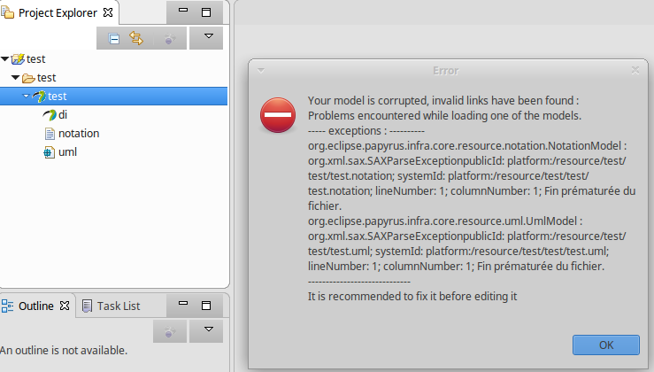

I'm new to papyrus and I'm currently trying to create a new papyrus model programmatically. The model such created should be part of a custom project type that I've already created.
I've already seen some solutions to this question for previous versions of papyrus; a few topics I used for my solution are this, this, and this. They seemed clear enough for me, except they don't work in my program. I'm working on Oxygen and some of the classes used in those solutions have been replaced so I'm stuck...
Here is what I do so far thanks to the solutions listed above:

The project (and everything happening in this code snippet) are created on the performFinish() of a wizard I coded. The wizard is supposed to create a new custom project.
I attached to this topic a screenshot of the error I get when I launch my program. I can sort of understand where it comes from (the notation file) but I don't know how to fix it. I thought the modelSet.save was supposed to create the three files (.di, .notation, .uml) automatically but it didn't work before (hence why I create the files myself). I'm aware I'm probably doing a lot of things wrong but I don't know how to fix it.
Would anyone have a lead?
Thank you for reading through.
