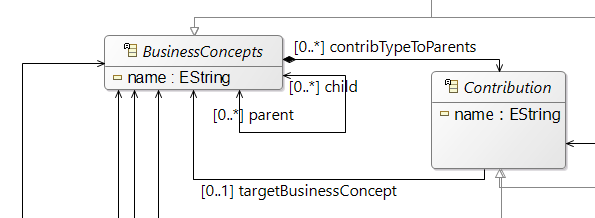

What I want to do is when I delete Make relationship (i.e., ++ relationship),
the value of Problem2's parent attribute be unset by Problem1.

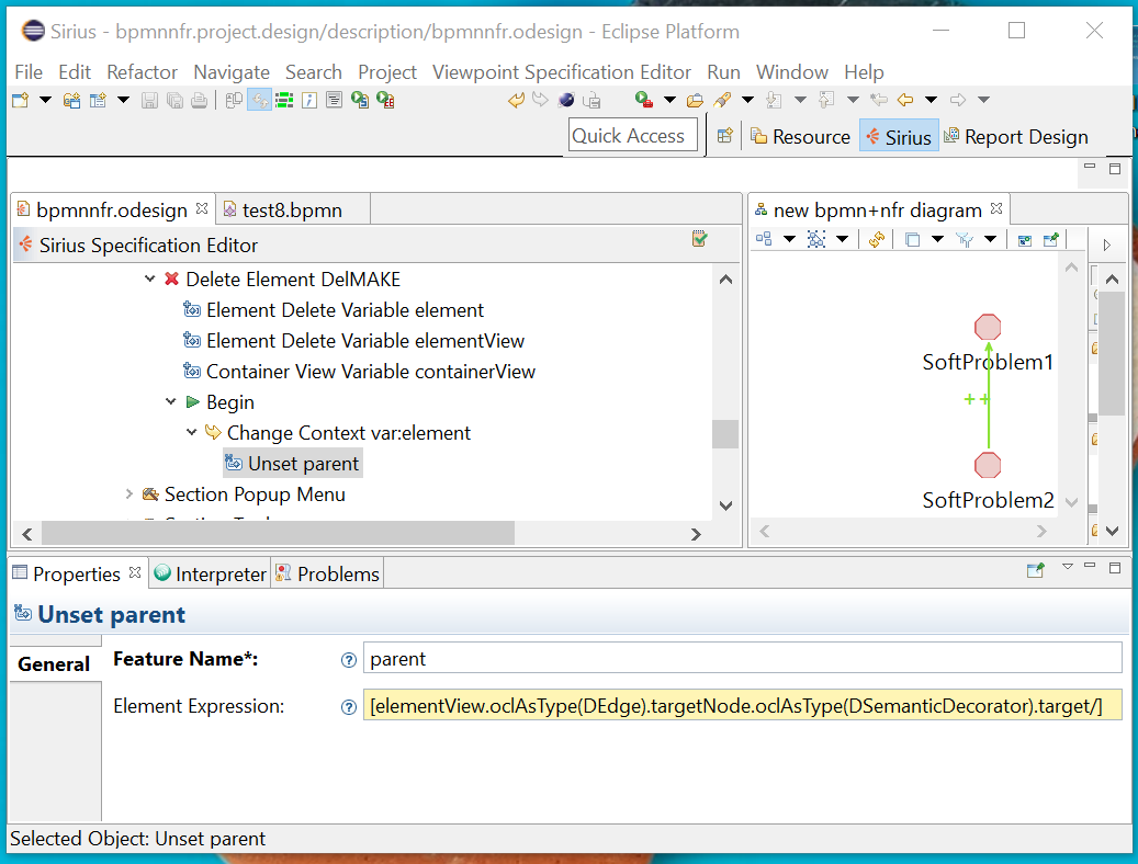

I used 'Delete element' and set the following.
In Change Context, browse expression - var:element
In Unset, Feature Name - parent
Element Expression - [elementView.oclAsType(DEdge).targetNode.oclAsType(DSemanticDecorator).target/]
The problem is when I delete edge, it doesn't work.

If I understood correctly the confusion here is between org.eclipse.sirius.viewpoint.DSemanticDecorator.getTarget() and org.eclipse.sirius.diagram.DEdge.getTargetNode().
- DSemanticDecorator.getTarget() represents the reference between a graphical element (DNode, DNodeContainer, DEdge) and a semantic element.
- DEdge.getTargetNode() represents the reference between an edge and the target Node.
However, in your case using DEdge.getTargetNode() would work only if your diagram is unsynchronized. What your delete tool should unset, is not the graphical element, but the semantic element. Therefore, you should not use the elementView, but the element variable and then unset the reference you are looking for (targetBusinessConcept?).

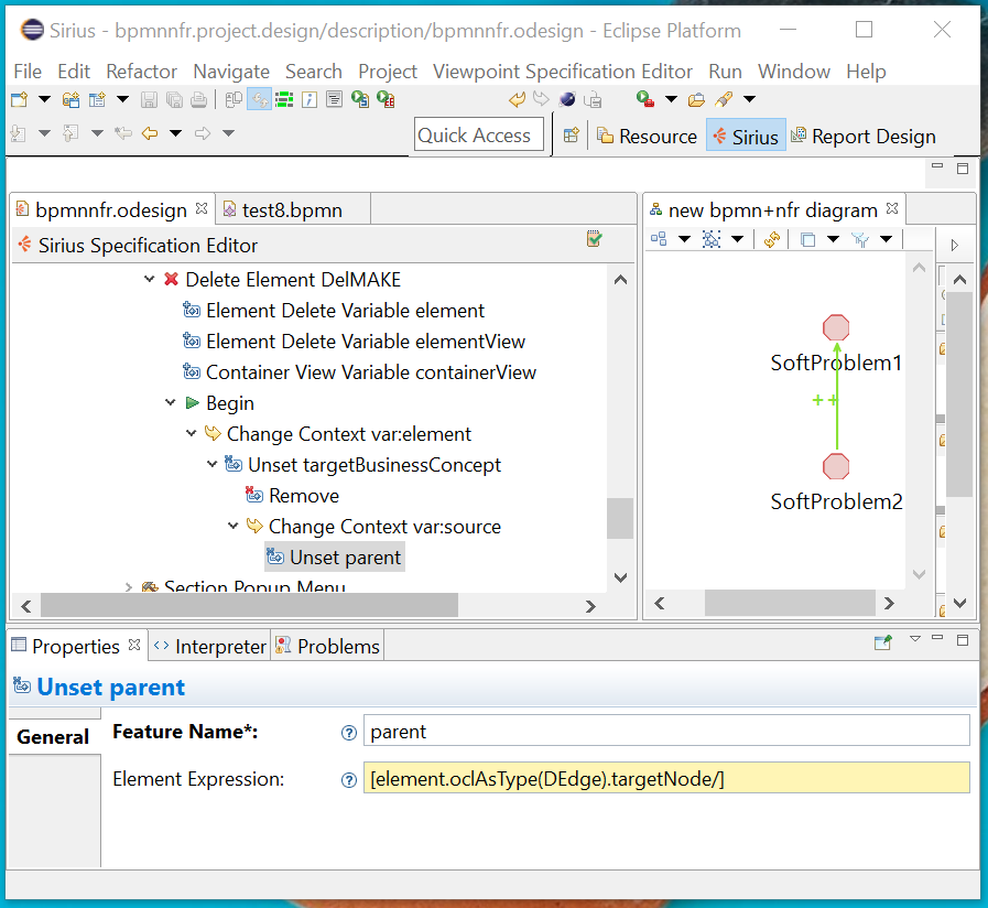

Re: When delete edge [message #1769222 is a reply to message #1769171] Thu, 27 July 2017 22:37 Go to previous messageGo to next message
I could success to delete an edge and unset what I wanted (feature name: targetBusinessConcept).
What I want to do one more thing when an edge is deleted is also unset the value (feature name: parent) in a source of the edge.
As the previous image, under the "delete" function, I changed context as "var:source" and unset "parent" with [element.oclAsType(DEdge).targetNode/].
However, I couldn't what I expected.
Could you let me know how to fix it?
Thank you so much.
Grace
Re: When delete edge [message #1769272 is a reply to message #1769222] Fri, 28 July 2017 09:30 Go to previous message
It does not work because the element variable is a semantic element, not a DEdge. Furthermore, what you want to unset is in the semantic model, not the DEdge.targetNode reference. If you do unset the targetNode reference but not the reference in the semantic model, the refresh will recreate the reference in the graphical model (synchronization).
