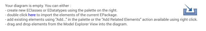

2. I checked the odesign file in EcoreTools project, I found when user double-click Empty-Diagram (like below), it will create view for the 'Not synchronized' elements. I need a function: automatic load the 'Not synchronized' elements when user creates a new diagram (need not trigger from double-click an image).
index.php/fa/30128/0/
I tried defining the 'Begin' in the diagram, but it can't work, maybe the 'Container View Expression' is not correct. How to implement this function?

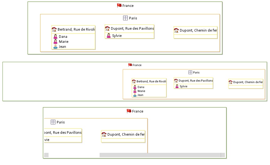

4. How to resize the Container width when user moves the inner element from right to left.
For example:
There is a Diagram like below.
index.php/fa/30130/0/
When user shifts Paris from left to right side, France container will automatic increase its width value to cover Paris.
But when user shifts Paris from right to left, France will not change its size to cover Paris.
I need implement a function: the behavior (when user shifts Paris from right to left) same to the behavior (when user shifts Paris from left to right).
How to implement it?

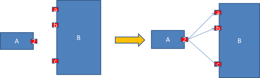

5. I have a requirement: When user connects A and B, the port will connect like: 2-a, 2-b, 2-c.
index.php/fa/30131/0/
I think implement this requirement by configuration in odesign is very difficult. So I implement this function use Java Service. I define a "Change Context: aql:source.Connect(source, target)" in odesign. And implement the connect operation in Java code:

The behavior is OK now, but I don't know is it a correct way to implement the requirement. Can I change the model value by Java code in here? Does it cause other problems?

2. "Not synchronized" diagram element is not the default behavior. On a (Node/Container/Edge) mapping, in the advanced tab, by default the synchronization field is set to unsynchronizable. This means that by default every candidate element will appear on the diagram (but it can be unsynchronized by the user). Therefore, the behavior you want is the default one. The Ecore Tool uses the "Not synchronized" feature in order to let the user display only what he wants.
Thanks for your explanation, I know the difference between "Not synchronized" and "Unsynchronizable", and I know the EcoreTools uses the "Not synchronized" feature. The function I need is same to "Double click Import Current EClasses"(defined in "Entities in a Class Diagram"-"Default"-"Section Existing Elements"), but I wish the diagram could import the element by default with a condition, need not user double click an image to trigger the import action like EcoreTools. I already implement a function "Container Drop" for user imports other element to the diagram.

5. I am not entirely sure what you are doing without the images but yes you can change semantic elements values in your Java code as the modification realized by a tool are executed inside a RecordingCommand (EMFT).
So I will modify the semantic elements values. And I found I can change the view after "Create View".
I think user java Service to modify it is more easy and clarity than configure many items in odesign file.

2. I am not entirely sure to understand what you want to do. From what I understood, you should have two mappings:
- one mapping that is synchronized and with a precondition. This way, when the diagram is created the candidate elements will be displayed automatically.
- another mapping that is unsynchronized and your Container drop uses this mapping to display the element you drag and drop.
- both mappings uses the same style so the user will not see the difference.

5. If your Edge mapping is synchronized, you should not have to add a "Create View" operation, as the graphical element will be automatically created on refresh.
You can create the reference using java code, but I do not think it would be difficult using the Model Operation in a Edge Creation Tool. You should only need some "Set Value" operation and a "Create Instance" operation if you are using an Element Base Edge Mapping.

For Question 4:
When users drag Paris from left to right, France container will automatic extend its boundary to cover Paris.:
But when users drag Paris from right to left, France's boundary will not be adjusted to cover Paris.
https://www.eclipse.org/forums/index.php/fa/30130/0/
Paris will be hidden when user move it to left. is this a normal feature of Sirius?
