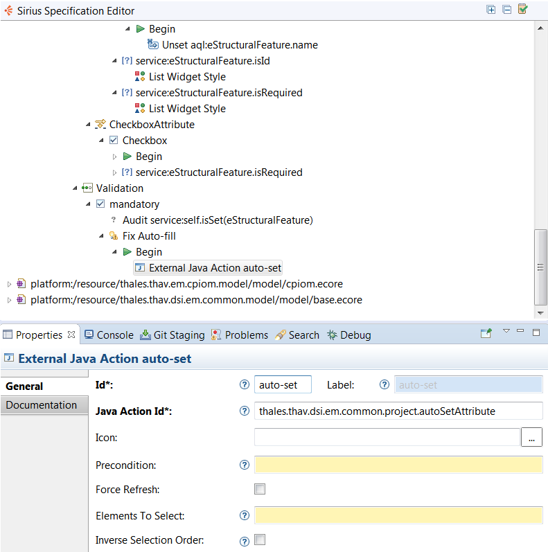

The only problem we face for now is that a simple Quick Fix using external Java Action is not working anymore. You can see the definition of this feature in the attachment (quickFix.png).

The service code extends org.eclipse.sirius.business.api.action.AbstractExternalJavaAction and overrides both execute and canExecute methods which are not reached in debug mode.
We are running out of ideas after few hours of research and tests.

The external java action mechanism has not been changed recently. The one in the org.eclipse.sirius.sample.ecore.design still works fine, both execute and canExecute methods are reached in debug.
Do you have an exception somewhere? Does your VSM validates? Do you have your metamodel added to the "Selected Metamodels" on you diagram description (tab metamodels)?
