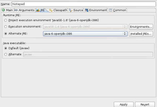

Re: How to compile & run a multi-class & a complete program? [message #1768829 is a reply to message #1768821] Mon, 24 July 2017 04:20 Go to previous messageGo to next message
Exception in thread "main" java.lang.Error: Unresolved compilation problem:
	at Notepad.main(Notepad.java:603)
Run as Configuration:
index.php/fa/30090/0/
[Updated on: Mon, 24 July 2017 04:33] by Moderator

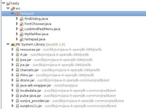

Re: How to compile & run a multi-class & a complete program? [message #1768869 is a reply to message #1768842] Mon, 24 July 2017 09:47 Go to previous messageGo to next message
Ed Merks wrote on Mon, 24 July 2017 06:04
... the zip file does contain *.java files. Use File -> Import -> General -> Archive File to import the 5 *.java files into your Java project's src folder
Java Project named "Tasty".
Only 5 java files imported from the zip archive with filter *.java
Then what, please inform!
The result is below:
index.php/fa/30094/0/
Re: How to compile & run a multi-class & a complete program? [message #1768892 is a reply to message #1768869] Mon, 24 July 2017 12:06 Go to previous messageGo to next message
Notice you have a Notepad folder. But these .java files don't declare a Notepad package; so they must be ad the root. Move all the *.java files directly into the src folder and delete the Nodepad folder.
