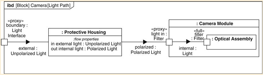

To be ultra-concrete, I've attached an image taken from the book A Practical Guide to SysML, which show an ibd of a block called Camera with a port (shown on the frame) called boundary: Light Interface. How would you communicate the same information about the usage of the port on this block?
Thanks again!
