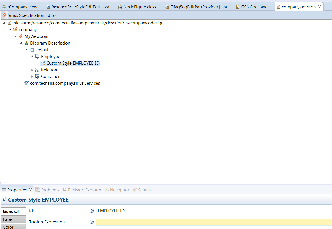

You also have to create the DiagSeqConstants.INSTANCE_ROLE_STYLE_ID that point to the id you use in the custom style on the odesign.

Add Custom Style in Employee Node (odesign file). ID: EMPLOYEE_ID

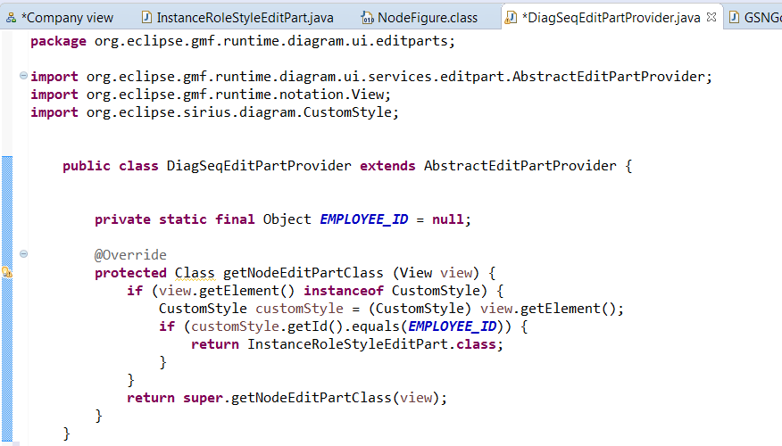

DiagSeqEditPartProvider Class: DiagSeqConstants.INSTANCE_ROLE_STYLE_ID replaced by EMPLOYEE_ID

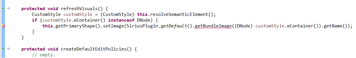

In the last lines, this code has an error.

Replace SiriusPlugin.getDefault().getBundleImage((DNode) customStyle.eContainer()).getName() by
    protected void refreshVisuals() {
        CustomStyle customStyle = (CustomStyle) this.resolveSemanticElement();
        if (customStyle.eContainer() instanceof DNode) {
            ImageDescriptor imageDescriptorFromPlugin = AbstractUIPlugin.imageDescriptorFromPlugin(Activator.PLUGIN_ID, "/icons/myIcon.png");
            this.getPrimaryShape().setImage(imageDescriptorFromPlugin.createImage());
where "/icons/myIcon.png" is the path to your icon in your plugin. And be sure that the folders of your path are ticked in the build section of your manifest.mf
Also your EMPLOYEE_ID value in DiagSeqEditPartProvider must be set to the value used in your odesign:
String EMPLOYEE_ID="EMPLOYEE_ID"
