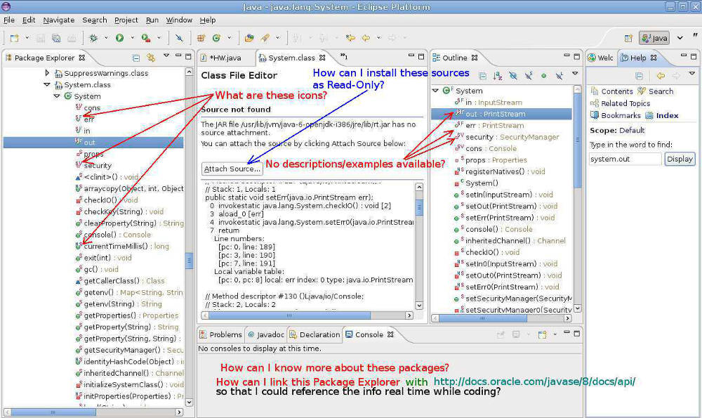

Isn't there any (individual) contextual method- & object- list, (individual level) information (including guidance with examples) & support available during typing of codes in Eclipse? One which is available is not comprehensive, and the information available is not supported by examples. Like I have attached a snapshot here and put my questions there?
I don't have the language of a Java programmer to explain myself -- like what I need.
But if anyone has used Adobe Flash that person will know what "Contextual Help & Reference" means.

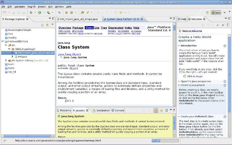

I right click and find options Open Attached Javadoc Shift+F2
When I click on the option I find the html format in the Java perspective with information on System. [Snapshot attached]
index.php/fa/30031/0/

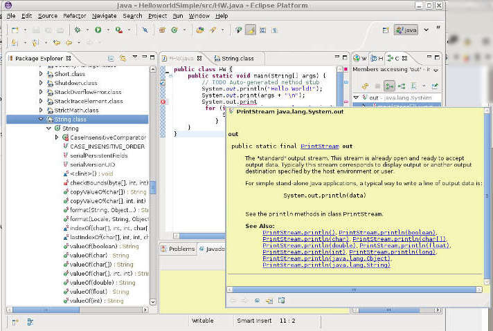

The Javadoc says:
PrintStream java.lang.System.out
out
public static final PrintStream out
The "standard" output stream. This stream is already open and ready to accept output data. Typically this stream corresponds to display output or another output destination specified by the host environment or user.
For simple stand-alone Java applications, a typical way to write a line of output data is:
System.out.println(data)
See the println methods in class PrintStream.
