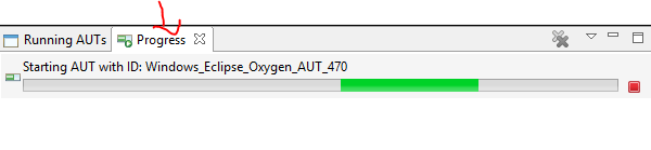

We are developed some automation scrips for Eclipse Luna, Mars, Neon and now planning to extend those scripts to Oxygen version, to check the our plugin comparability with Oxygen version.
Issue: AUT is not starting, even though , i have defined the AUT (same process followed for other eclipse versions: Luna, Mars, neon)

Re: Eclipse Oxygen (4.7.0) is compatible with Jubula 8.3.1.125 version? [message #1768118 is a reply to message #1768070] Thu, 13 July 2017 13:58 Go to previous messageGo to next message
I have tested Jubula (Version: 8.5.0.127) with Eclipse Oxygen
Version: Oxygen Release Candidate 3 (4.7.0 RC3) and Build id: 20170608-2000) and
Version: Oxygen Release (4.7.0) Build id: 20170620-1800) AUT is not starting.
Even i am not seeing any information in log file (C:\Users\XXXX\.jubula\logs).
Tried with Neon (Version: Neon.1a Release (4.6.1) Build id: 20161007-1200) and AUT is starting.
Seems to me, Jubula is not compatable with Eclipse Oxygen.
Also tried Jubula (Version: 8.3.1.1250) with Oxygen Release (4.7.0), AUT is not starting.
Here is am using 'org.eclipse.jubula.rc.rcp_4.0.0.201611030931.jar' under "\eclipse\plugins" location.
Also tried replacing 'org.eclipse.jubula.rc.rcp_5.0.0.201705050842.jar', still seeing same issue.
I got some information in log file. Attached (Jubula Oxygen Log file.xml) log file for reference.
Looking for work around or assistance.
